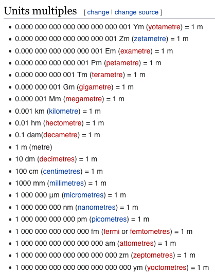

What happens after 1nm? Do we go negative?
Negative, space/particles/size gets smaller, not negative.
1 nm is 1000 picometer so a next step might be 0.9 nm=900 picometer.
