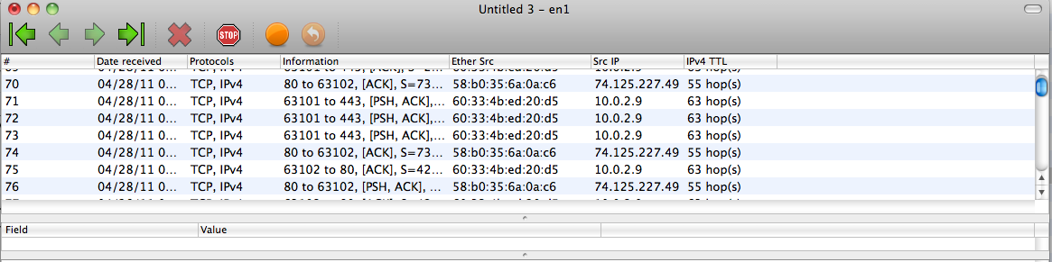

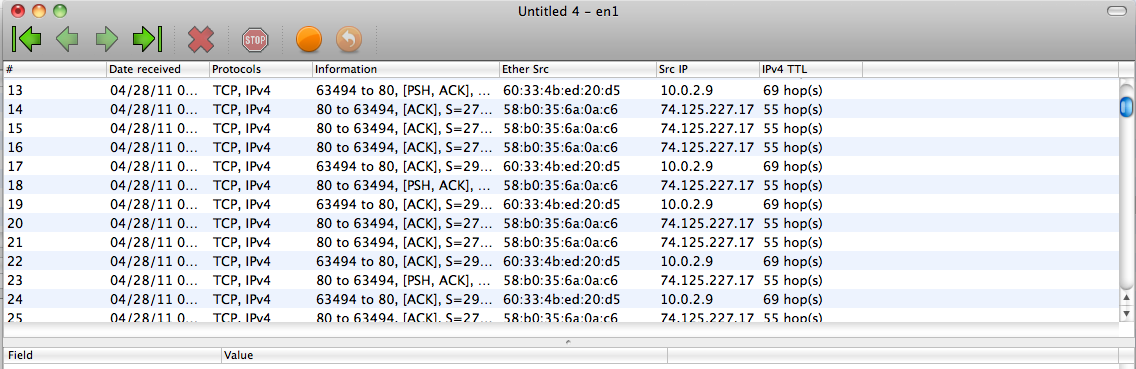

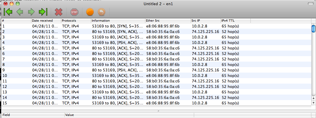

Below are some screenshots of a network sniffer in promiscuous mode to show you "how it works".
As I said, I've tested this. Put together the test case again for the screenshots. I connected my iPad and my iPhone to my MBP via a shared wireless connection from the MBP. The iPhone (10.0.2.9) was at the default TTL=64. I then set MyWi on the iPhone to bridge the USB tether to WiFi and connected my wife's MBP default TTL=64 (so this IP is 10.0.2.9 to our sniffer) to the USB. Next I set the iPad (IP address 10.0.2.8) TTL=65. Screen shots show an exchange with google for each device.
First screenshot (Untitled) - shows the TTL of 64 coming from the iPhone.
Second screenshot (Untitled 2) - confirms that on the first hop the TTL is different on the iPad (65).
Third screenshot (Untitled 3) - Now I start making requests from the MBP tethered to the iPhone. These packets HAVE A TTL OF 63 (one less than the default 64) until I start modifying the client TTL because they have been routed through the phone
Fourth screenshot (Untitled 4) Modified the TTL on the tethered MBP to 70 so I could set it to 69 in the screenshot - I can set it to whatever I want below 255 and it will be decremented by one.
If you have insight as to why the TTL of the packets might not be what they are using to detect then please share, but the reasoning for the hack itself is sound and "right" from a logical AND technical perspective and I'm not going to spend any more time proving the concept.
