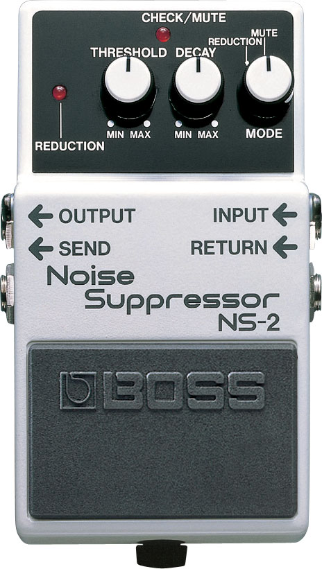

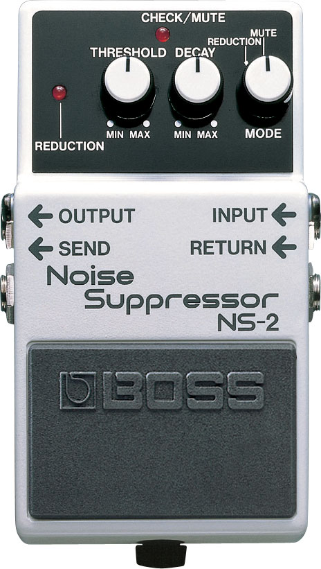

I am not a bass player, but I am a guitarist that uses a 1964 Fender 2x12 Bassman. My amp buzzes every once and a while I have found that using too much gain in the amp or on an external effect pedal can cause your amp to buzz or get "fuzzy."
My suggestion- Turn the gain/or whatever you bassists use to get your "guts" down until the buzzing stops, and if that is too extreme a change for your tone then go with the Noise Suppressor.
http://www.bossus.com/gear/productdetails.php?ProductId=151
