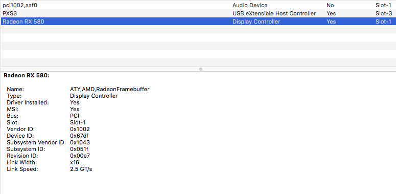

I bought Sapphire Pulse Radeon RX580 8G DDR5 DUAL HDMI/DVI/DUAL DP OC W/BP (UEFI) card to replace my old Radeon HD5870 Mac edition in my Mac Pro 5.1. It has one 8 pin power socket. I made a 2x6 pin to 8 pin power cable by myself for try it at the moment. So card works in 10.13.6, it looks like "Radeon RX 580" in system setup, but it shows PCI-E speed only 2.5 Gt, and no one of 2 Display Ports work, only DVI and HDMI ports, and is a problem for my 3-monitors configuration... I tried to connect to card's DP a native DP monitor, or DVI monitor by DP to DVI dual link adapter (with additional usb power), no reaction at all. Now I replace new RX 580 with my old card, so I can not say part number from system, new card has PN 299-1E387-000SA label on it. What do you think, is it card broken, or that may be bios/framebuffer problem? Would bios flashing solve that PCI speed and DP working problems, or I have to try something else? Thank you!
I think the Link Speed is only solved in the 138.0.0.0 or 140.0.0.0 BootRom. Since you're still on 10.13.6 you'll only get 2.5GT/s. That's what I'm getting on the identical card you have.
Thank you. But, did you try flash another bios to your card? Maybr it will help to fix that issue with PCI speed in High Sierra

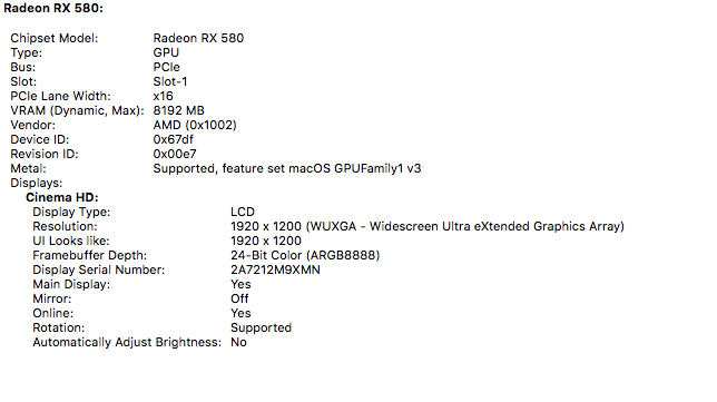

I have RX580 Nitro+ with part number 113-1E3660U-O51. I have problems with Mojave. Can I install bios mod with guide page 1?
I have also Nitro + it seems to work fine in Mojave , what tool did you use to test hardware decoding?
Boot ROM Version: MP51.0089.B00
