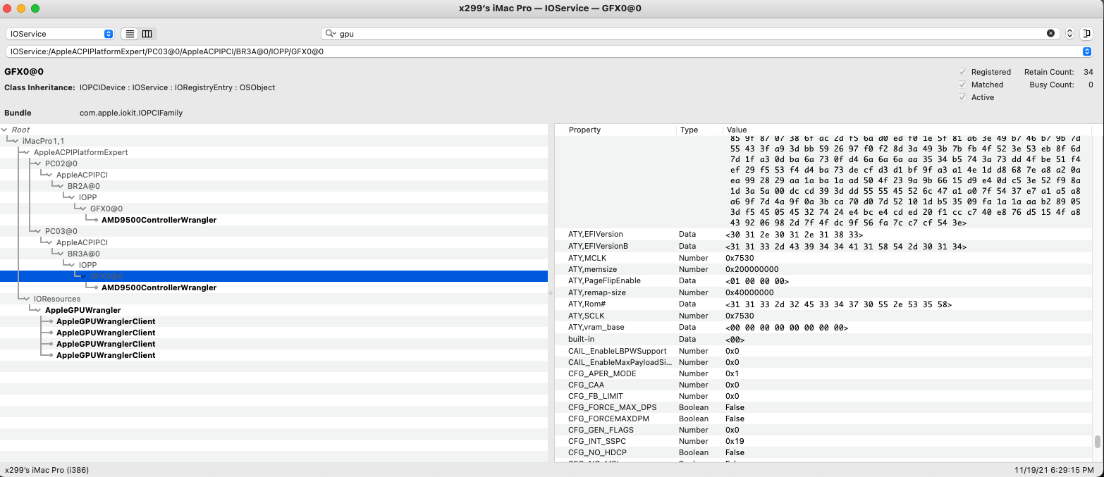

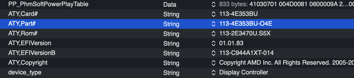

See here how to inject custom DeviceProperties

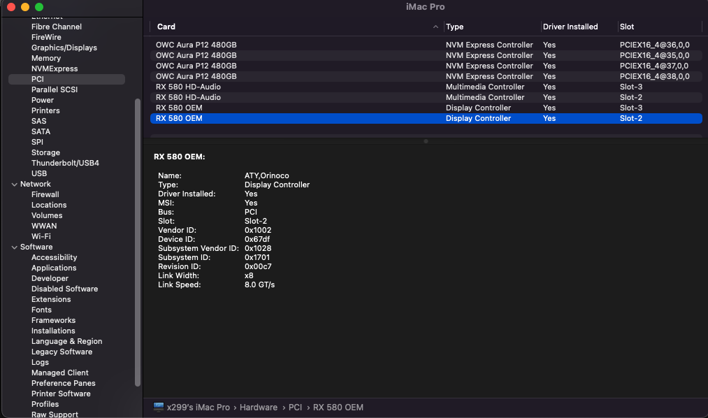

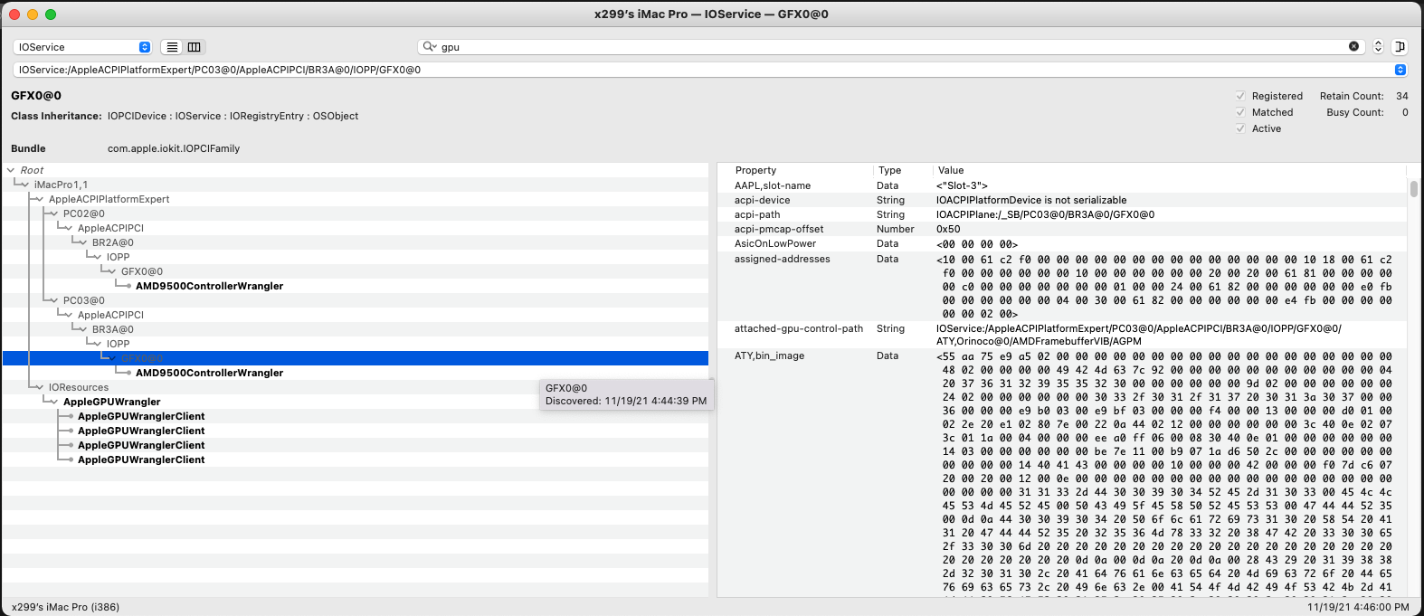

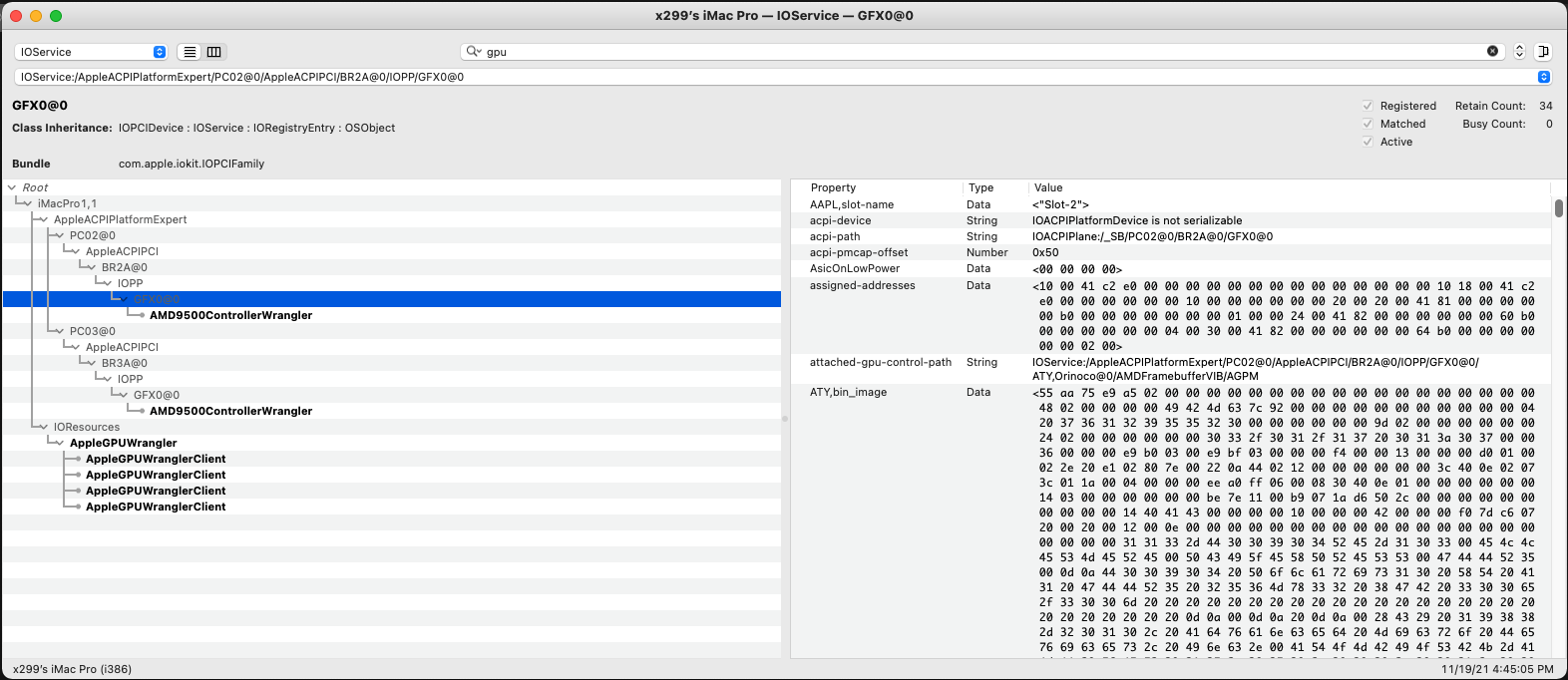

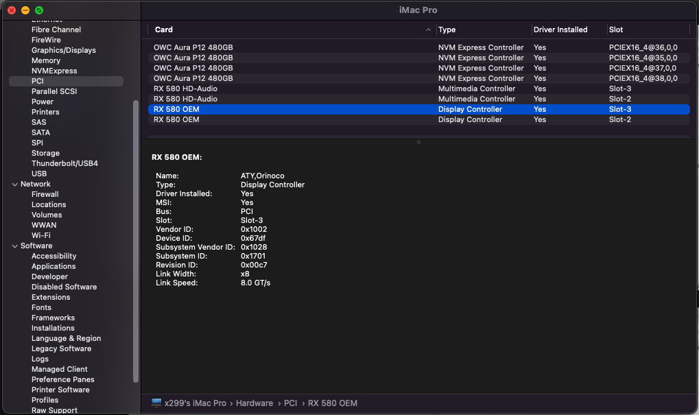

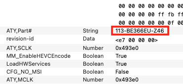

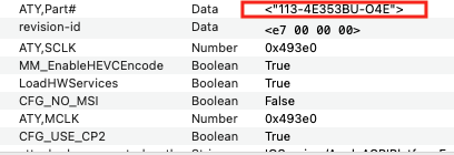

Thx. I was jus curious to know if by injecting Mac Edition's part # under DeviceProperty would make macOS to use Orinoco FB as it would after flashing vBios with Mac Edition's part#. So I did some testing
After injecting these properties,
Surprisingly, in ioregistryexplorer, it actually shows the part# in my GPU's original vBIOS (If not injected it would not show at all)
When the orinoco FB is injected, It does display the injected part#.
Same result with SSDT method. Anyways, like you said, this adds no value.
Here are my 2 SSDT's for RX-580s in slot 2 and 3 of my X299 iMacPro:
ATY,Part# will not work. Look at my SSDT:
It seems to me its necessary.

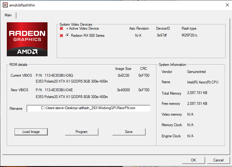

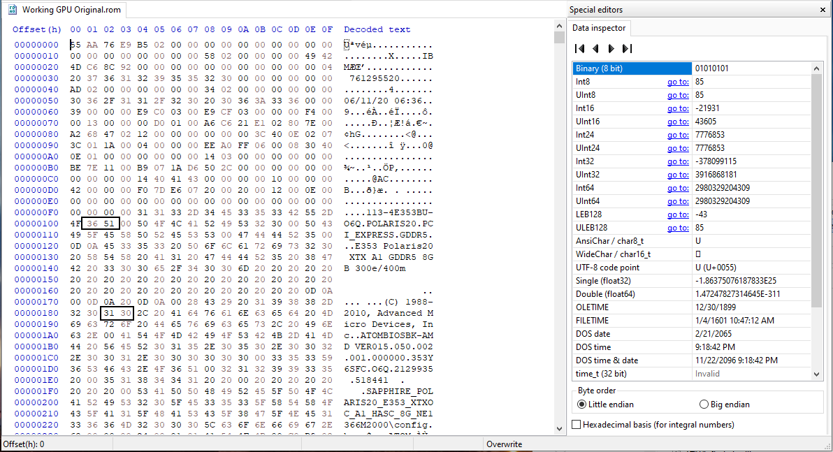

I apologize for resurrecting an old and perhaps outdated thread but since I just got a Sapphire Radeon Pulse RX 580 (with dual bios) that I struggled to get working (and finally did with the right VBIOS) I was curious about a couple of things.
First - is there any benefit from having the ORINOCO frame buffer if you are running open core with hardware acceleration enabled?
And second, even if there is no benefit I am stumped as to what I am doing wrong trying to modify my working VBIOS to insert one of the "whitelisted" part numbers.
I have screen shots of before and after modifications. I am trying to only change a 6Q to a 4E. This is reduction of xE so if I add xE elsewhere I should have the same checksum. I changed the year from 2010 to 2069 - adding a 5 and 9 which is xE.
The VBIOS flashed fine but when I reboot the screen remains blank - I don't even seen the Apple Boot manager (I have enablegop in my boot rom). I can reflash with my "working" VBIOS and all is good but I don't understand what I am missing - what mistake am I making that is causing my modification to fail?
As an update - I booted into MOJAVE without OpenCore and there I DO have the ORINOCO Frame Buffer showing with my original VBIOS (113-4E353BU-O6Q). It would appear that with OpenCore I get the standard Radeon Frame Buffer even though my VBIOS gets the ORINOCO booting with a compatible macOS.

Try this tool:
Code:
./rom-parser /Users/mbp151/MyTools/Sapphire.RX580.8192.171115_gop.rom
Valid ROM signature found @0h, PCIR offset 258h
    PCIR: type 0 (x86 PC-AT), vendor: 1002, device: 67df, class: 030000
    PCIR: revision 0, vendor revision: f32
Valid ROM signature found @ec00h, PCIR offset 1ch
    PCIR: type 3 (EFI), vendor: 1002, device: 67df, class: 030000
    PCIR: revision 0, vendor revision: 0
        EFI: Signature Valid, Subsystem: Boot, Machine: X64
    Last image
Code:
./rom-fixer /Users/mbp151/MyTools/Sapphire.RX580.8192.171115_gop.rom
Modify vendor ID 1002? (y/n): n
Modify device ID 67df? (y/n): n
    Last image
ROM checksum is invalid, fix? (y/n): y
0x87-0x79=0xE (Reduction of 0E)
Try this tool:
Code:
    Last image
Code:
    Last image
Thanks - I will give it a try.
So if I am correct then I need to add 0xE elsewhere - which is what I think I did....if you can look I added 5 and 9 to the years (decade and years) changing 2010 to 2069.
I'll let you know how it goes.
