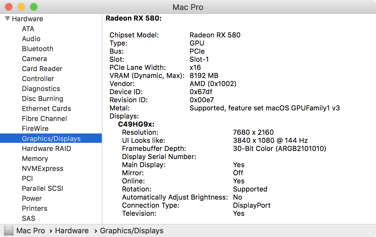

Try to force the UI to run at HiDPI may able to fix the font issue.
e.g. in my case, my CHG90 is a 3840x1080 monitor. I intentional select 3840x1080 HiDPI (which means render at 7680x2160), and then let the GPU downscale back to 3840x1080. It will give you better font than any other setting in native 3840x1080.
In system info, should looks like this.
As you can see, the font rendered at a very smooth way with no discolouration at the edge (which is actually part of the font smoothing). So, when it downscale back to 3840x1080. It will looks smoother than normal setting, and no discolouration regardless which font smoothing setting you use.

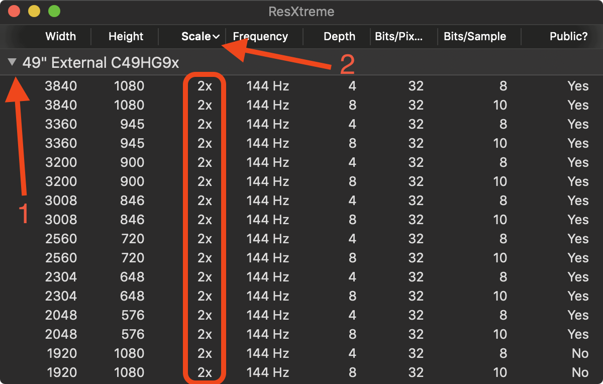

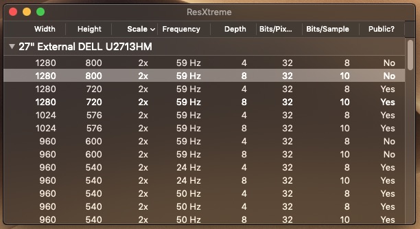

Thanks for the help "h9826790", ive tried forcing HiDPI but I only see an option for 1280x720 HiDPI, not one for 2560x1440, any idea how I may get this option to try it?
Use This
http://resxtreme.com
1) Click the triangle next to your monitor's ident to expend the list
2) Click "Scale" button to sort the list with all HiDPI (x2) options at the top
3) Double click the setting you want
If you monitor support 10bit and high frequency, you may select that as well

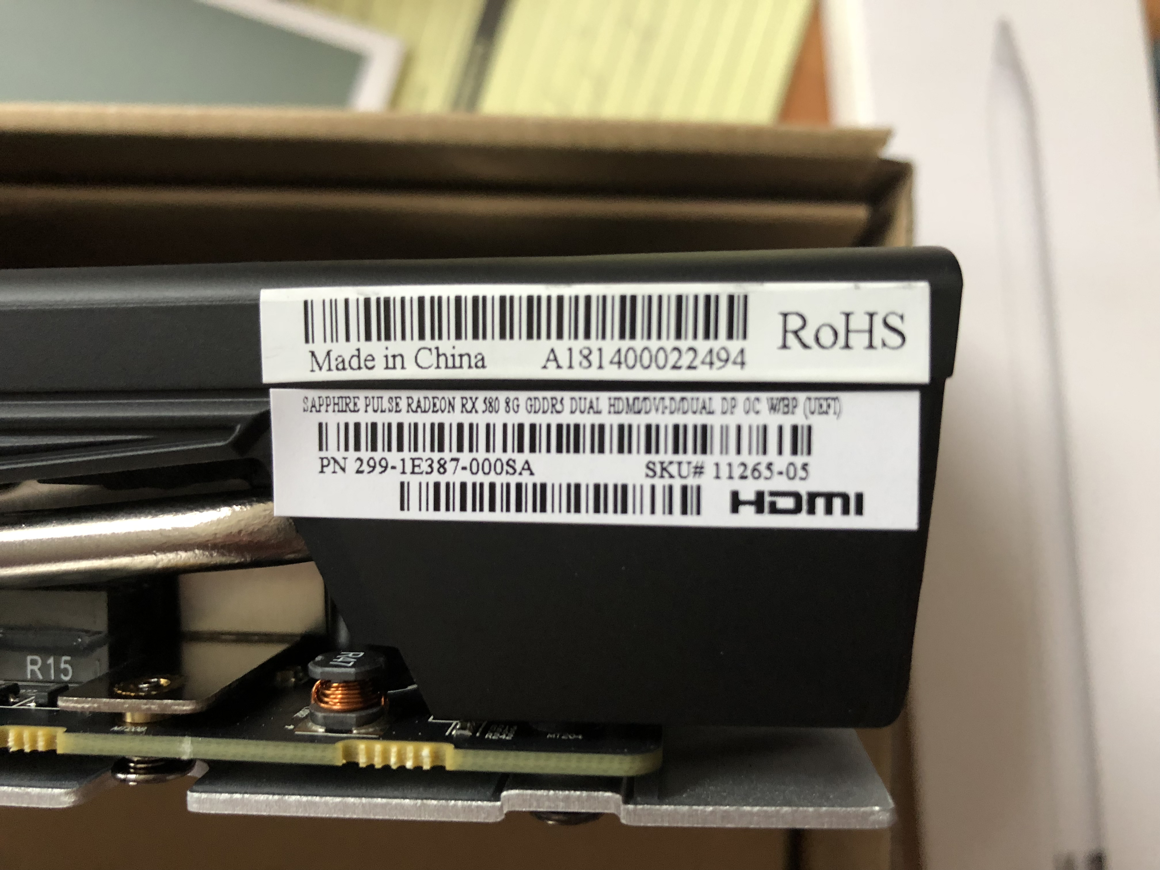

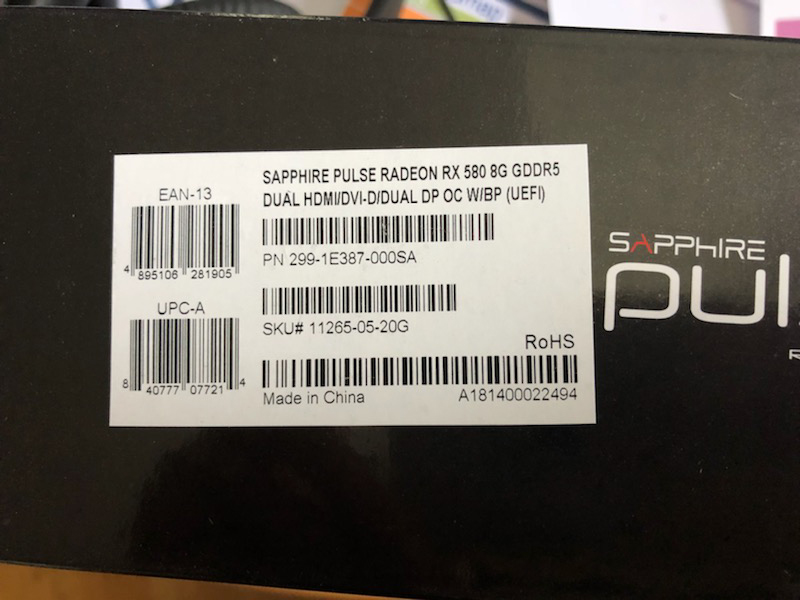

My new Sapphire Pulse RX580 8GB just arrived..... still waiting on my dual pin power cable to arrive.. from CHINA... could be another week or so.... but just wanted to ask if my Serial Number is one of the good ones... or the ones that will need to be FLASHED if I decide to go all macOS Mojave in the near future... :)

I received my brand new Sapphire Pulse RX 580 8GB today, installed with the proper power cable 18AWG and the mini display to display adapter on my 24" Apple LED Cinema Display and I have to say.....that I have a boot screen on what it looks, I even done several restarts and the cMP (4.1 to 5.1) boots with no problem, I have the black screen just a little bit longer but then afterwards I have the grey Apple Logo screen with the progress bar, then the desktop. For me it is a WIN in any case, and I can't complain for 1 second. Best move, ever made with Mojave 10.14 and the Boot ROM Version: 138.0.0.0.0:):):)
