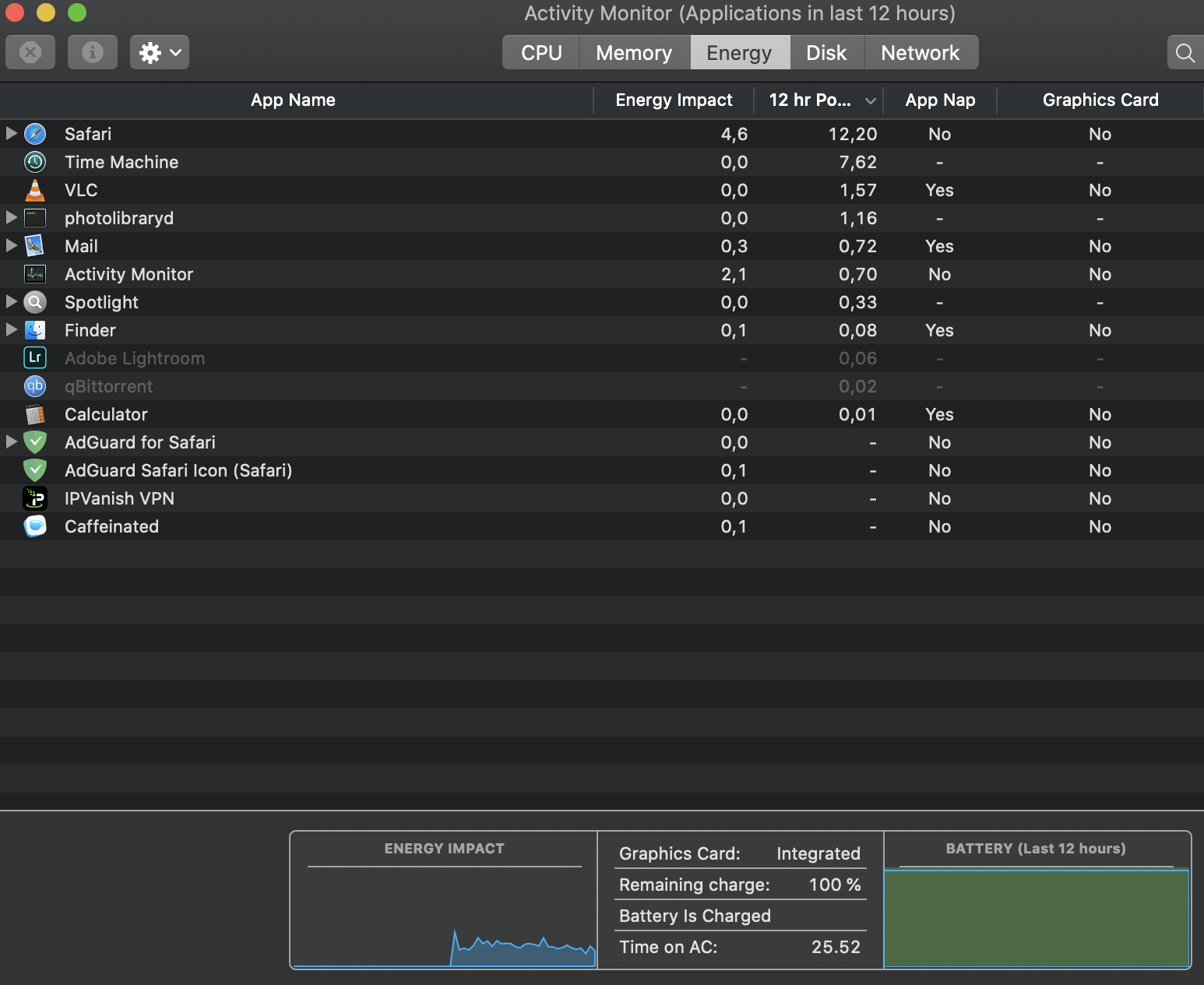

The system auto switches. If the dGPU isn't needed, it won't use it. Start "Activity Monitor", click "Energy" tab. If there isn't a "Yes" in "Grahpics Card" column, it will use the iGPU.
