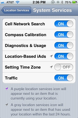

Switching off automatic time-zone sensing in iOS 5 can improve iPhone battery life significantly, according to iDownloadBlog. The site claims that a bug in iOS 5's GM release causes the GPS-enabled location tracking connected to the automated time-zone function to run constantly. This unnecessary use of the GPS circuitry may drain the battery exceptionally quickly.
To fix the alleged bug and avoid the battery drain, head to the Settings app in iOS 5 and tap Location Services and then scroll to "System Services" at the bottom of that window. Then switch off "Setting Time Zone".

I tried something this morning that seemed to help tremendously, i turned off the compass calibration. Havent gone below 90% all day.

on my iPhone 4 with iOS5 i turned the 4 bottom options off straight after upgrade and have had no adverse battery issues.

time zone sensing
Mine was also constantly active. I turned it off but I wasn't experiencing any problems. I'm on an iPhone 4 though, not 4s. Also, the addition of another email account to most people's phones (iCloud email) could be adding to the battery drain as there's another email address to push mail from or check at regular intervals. I got rid of two email addresses I didn't use that often and that significantly increased my battery life. I only have two now but I'd say I'd see another improvement if I cut that down to one.

Yeah... I think this is magical thinking.
Just because the arrow is purple, doesn't mean "GPS IS ON RIGHT NOW AND I'M DRAINING ALL YOUR POWER! MUHAHAHA!" It simply means the service "Setting Time Zone" it's doing something with your location.
Furthermore, just because your location is "being used", this doesn't mean that your phone has to do any power hungry operation to obtain your location. It likely just looks at the cell environment that you're currently in which doesn't require constant transmissions to cell towers! I assume it's looking at the most recent cached tower information (within a reasonable time frame) and uses that.
What does this feature do? Don't we calibrate the compass by waving the phone around like a madman?
Compass calibration adjusts magnetic declination (the difference between true north and magnetic north). The adjustment depends on your location, hence the location service. If you disable this feature, any app that uses the compass cannot use this feature.

On my iPhone, the gray icon wasn't even on, meaning it hadn't even tried to use location services for time zones in the past 24 hours. I'm not experiencing battery drain; I'm finding my new 4S has about the same battery life my 3GS did (which is good enough for me). I'm wondering if this is only triggered if the phone accesses towers from multiple time zones or something else to indicate that you're close to a time zone boundary. I live in Fort Worth, TX (nowhere near a boundary), so there would be no reason for it to constantly check my location to see if I've changed time zones. Perhaps it's different for someone located near a time zone boundary (Yuma, AZ; Columbus, GA; Chattanooga, TN; etc.), as it might enable location services to provide a more precise transition from one time zone to another. This is purely speculation - can anyone living near a time zone boundary verify this theory?

After switching all iCloud services off (except 'Find My iPhone') I could run 1 1/2 day, on very below my normal use.
I ended up disabling 3G when I didn't have the use for it, and that gave me back my 2 days of normal use. But it is a bit annoying having to switch that on/off.
But now that I have killed the constantly running location service by switching off 'Setting Time Zone', I definitely expect my 2 days battery life to be back without having to switch off 3G.
