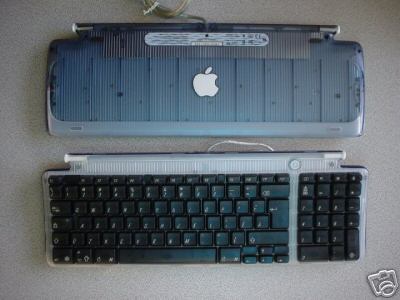

Original G3/G4 keyboard perhaps? This one came with a powerswitch on the keyboard.
I am pretty sure that when Apple stopped making those keyboards and replaced them with the Apple Pro Keyboards without the power button they stopped putting the extra circuitry in the USB ports to support keyboard startup in macs released after that. Seeing as that was in 2000 I'm pretty sure the G5 powermacs will not be able to startup from those keyboards.
