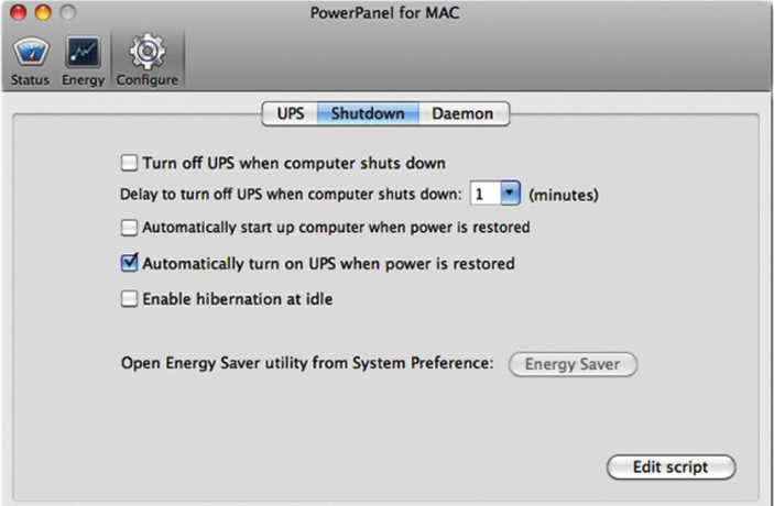

Is it possible to use a universal power supply (battery backup) to power up the mac without pushing the power button on the back of the display? IE, turn on the system when the UPS power is turned on...?

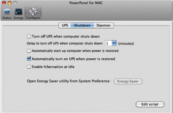

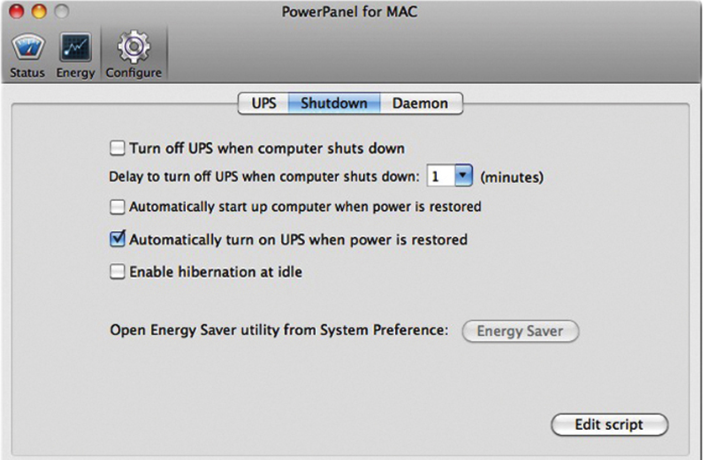

Not within MacOS, you'll need to use a third party solution to manage power up/shutdown behavior. I use Cyberpower PowerPanel with my CyberpowerUPS to manage Auto Startup to restore my server to operation automatically after a power outage when my Mac Pro shuts down. https://www.cyberpowersystems.com/product/software/powerpanel-for-mac/ Screen Shot 2019-06-03 at 1.30.38 PM.png

Not within MacOS, you'll need to use a third party solution to manage power up/shutdown behavior. I use Cyberpower PowerPanel with my CyberpowerUPS to manage Auto Startup to restore my server to operation automatically after a power outage when my Mac Pro shuts down. https://www.cyberpowersystems.com/product/software/powerpanel-for-mac/View attachment 840287
Hmmm, I am using an APC BackUPS... seems they don't offer a Mac version of their power manager. Damn.
