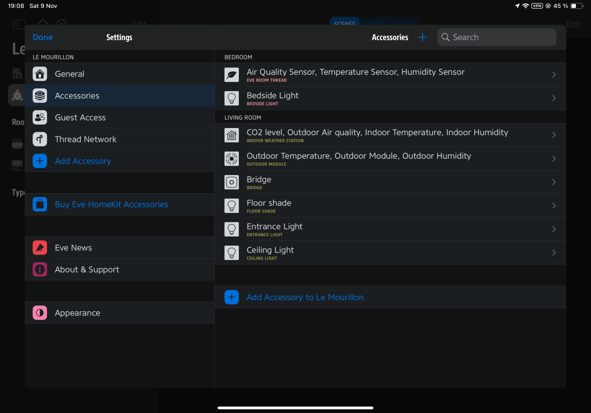

My Apple TV is not recognised in Eve.
they were suggesting an eve energy plug, a physical device to control the power going to your TV. You won't necessarily use it to turn the power going to your TV on and off, but they let you monitor power usage in real time, so you should be able to tell from that if the TV is on or not. You have to use the eve app to create that automation, since the home app won't let you trigger on power usage.
the aTV won't show in the eve app. it doesn't support multimedia devices. I'm pretty sure it just started supporting TVs with iOS 18.
