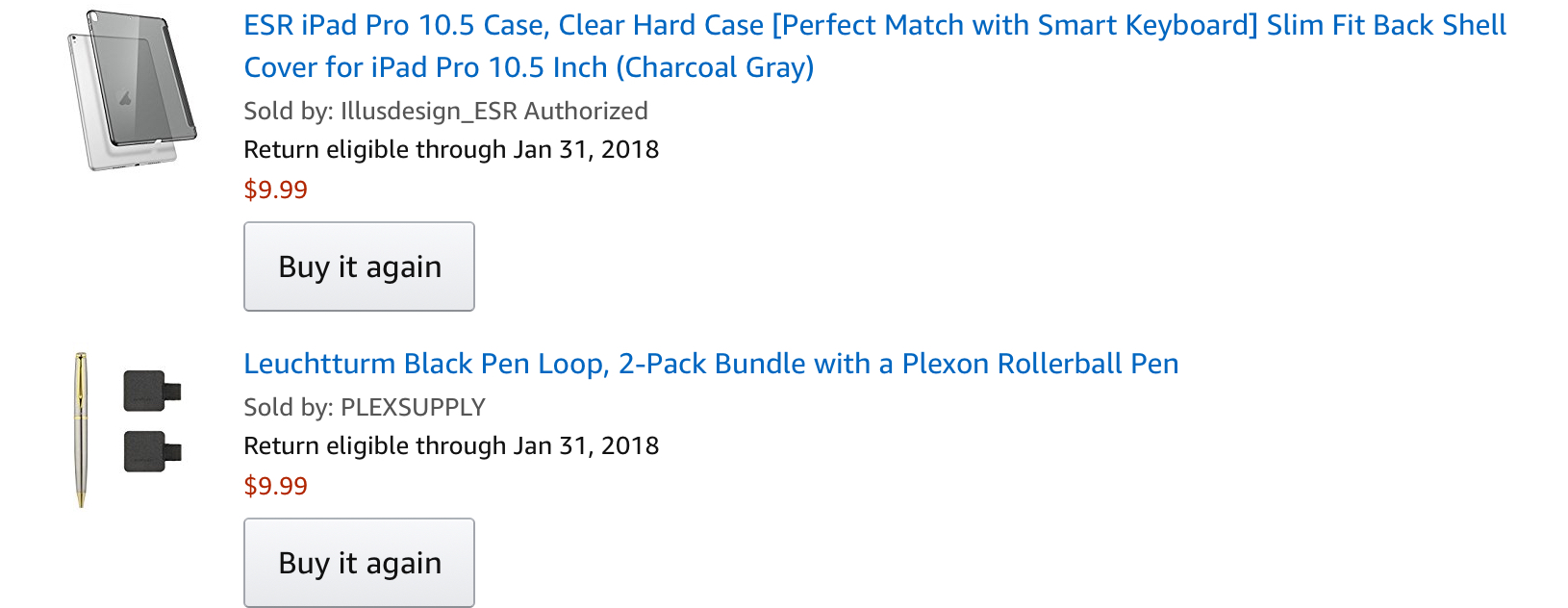

I would like a clip or storage of some sort to hook my Pencil to. I can't wait for something to be developed. Other than using some velcro. Lol
My Logitech Slim Combo keyboard case (the new one) has a loop at top—landscape. During the day as I use it off and on I use the loop, otherwise its in an SF case where i keep CC connector, Pencil tips and adaptor, etc
[doublepost=1511723321][/doublepost]
I have not had this problem at all--if the Pencil is not moving, even if my iPad is on, the Pencil does not drain or even show up in my battery widget. This is why I stopped using cases with attached Pencil holders, and why the first thing I did with my Tech21 case was slide the Pencil holder off and put it in a drawer. The Pencil goes to sleep if you're not using it and it's not moving. When it's asleep, the battery will still drain, but it will be very slow drain. If your Pencil is draining that fast even when it's not awake, there is something wrong with the Pencil.
I OFTEN PUT MY pencil in a SF case with CC connector, Pencil tip, adaptor, etc. It is not being handled, laid flat on table shelf. My Pencil battery still drops a lot quickly. I have not tried turning BT off but i often grab my Airpods during the day so would hate to do that—but I’ll try. My pencil is charging right now—again.
I purchased these a while back for my Oringinal 12.9 Pro. I use them now with my 10.5.
