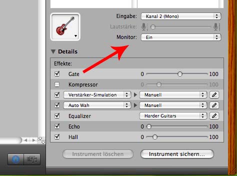

is monitoring turned on for the real instrument?
....in the info palette

thanks for the quick response Mydriasis.
as far as i can remember, i turned the monitor ON last night at one point, and suddenly I could hear through my headphones.... ELATION!!!
But.... then i realized I was just listening to the laptop's built-in microphone.
However, because I was messing with the system preferences so much, i may have momentarily had them set to the built-in mic instead of the Line In at the moment I turned the Monitor to ON.
I will try that again tonight with the monitor on and the Preferences set to Line In. That's what you suggest, right?
Again: thanks for the quick response.
