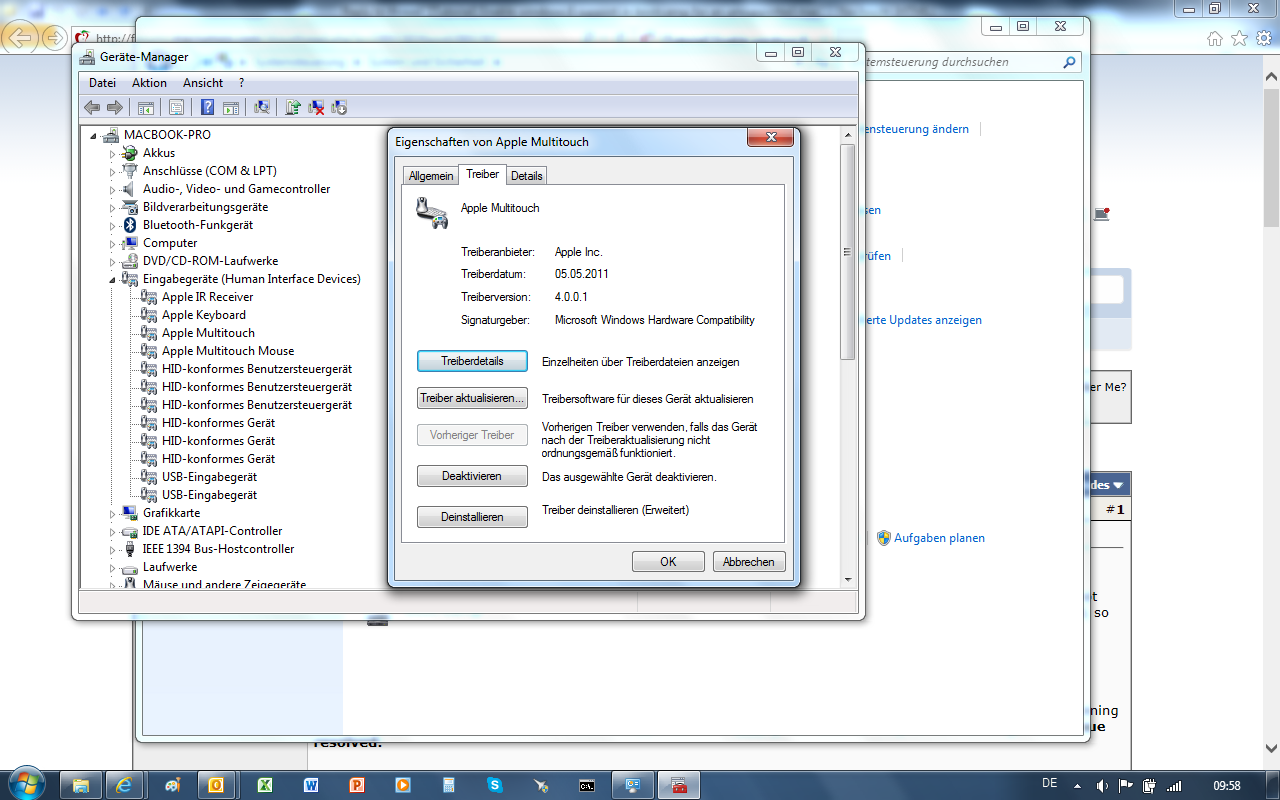

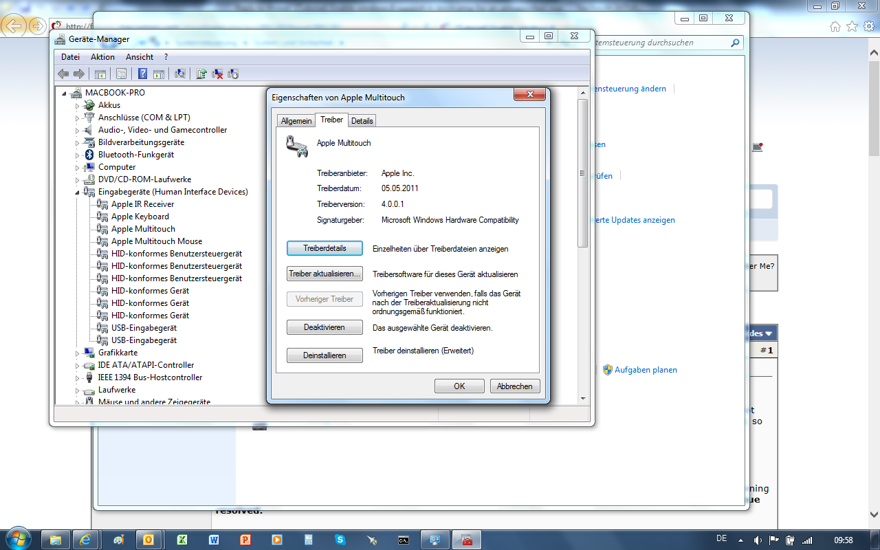

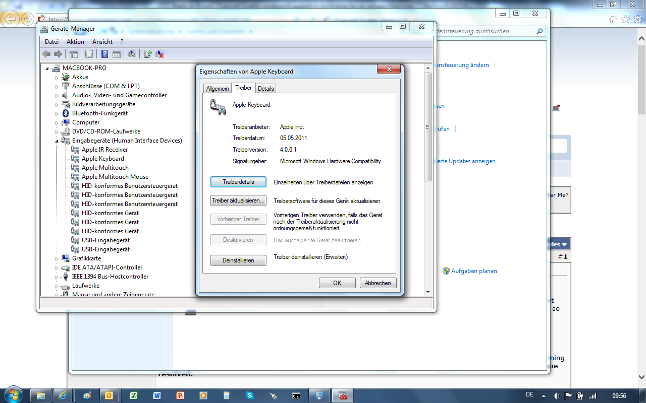

This is what I see ( W7, no problems with keyboard backlight ):

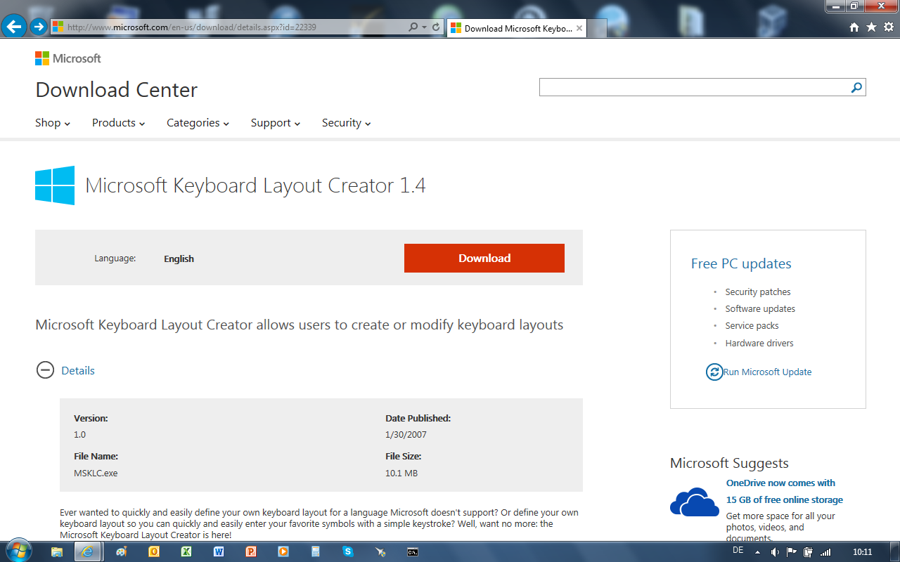

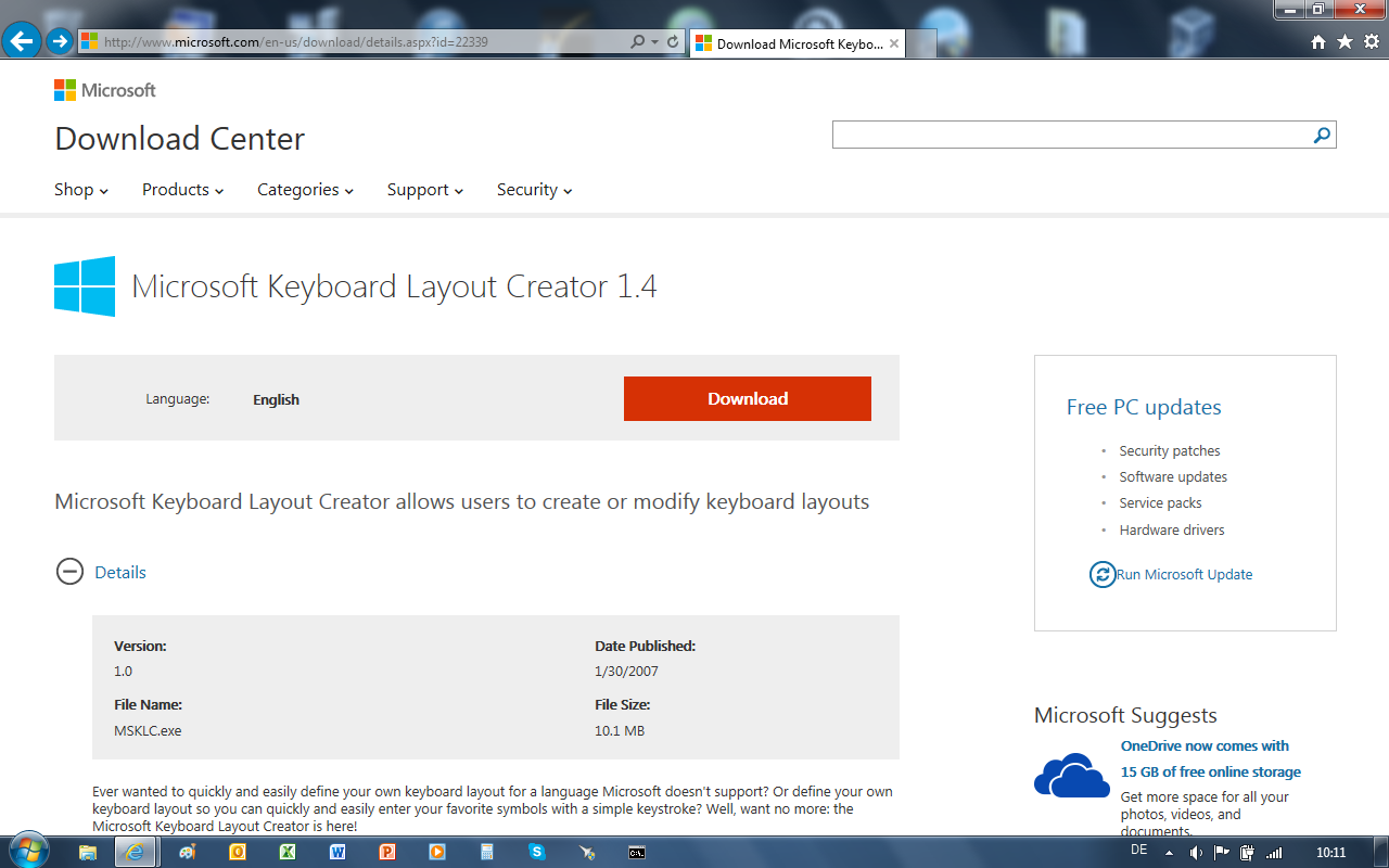

To finally tweak the keyboard ( I needed to do this as well ) I used this:
