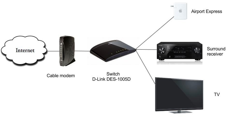

Hi! What do I need to change in the setup below in order to get the receiver and TV online? The Airport Express works as it should, providing wireless access to the web, but the receiver and TV won't connect. Do I need to replace the switch with a router, or do some other kind of configuration? Thanks.
Yes, you need a router between the modem and the switch. Lost of routers come with 4 ethernet ports so if that's all u need, u can get rid of the switch or put in on the shelf until u need more ports.
If u are paying a monthly fee for the modem, u can buy a modem+router in one, just ask the cabler for which "gateway" is suitable for their network. Save some$ there. Just make sure plugging the new gateway doesn't require a visit 'cuz the bastards may charge u for the bother.
Exactly as the poster above said, you need a router. The switch can then be used in conjunction with said router if you want, but it is not necessary. Most routers come with a 4 port switch built in so you have 4 LAN ports with the router, as well as the DHCP and internal network capabilities.
Just replace the switch with a router and you will be good to go.
Thanks, guys. So there's no way to use the Airport Express as said router? As in manually configuring the TV and receiver to ask the AE for an IP address, etc, like my wireless devices do?
If the tv and receiver use wireless then yes you could connect them.
However, if they don't have wifi they would need a wireless to ethernet bridge device to connect them. You could plug it into the switch and it would give the TV and receiver access to the Airport Express.
IE something like this: http://www.hhgregg.com/linksys-by-cisco-wireless-n-ethernet-bridge-with-dual-band/item/WET610N
It would be just cheaper to get a router with a built in switch, however.
U can use the AE as long as it has a WAN port, then hookup its LAN port to the existing switch, so basically move the AE between the modem and the switch. U will need to go into the AE and do some configuration.
The Airport Express only has one ethernet port.
