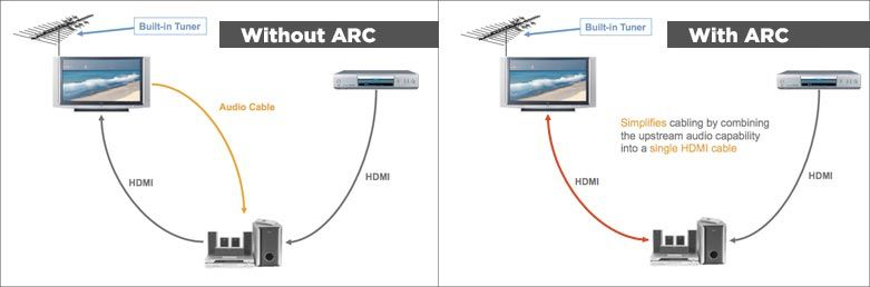

a little more in-depth on the two things
CEC - Consumer Electronics Control - used to send commands over the HDMI cable, and goes both ways, Your TV remote will be able to control basic navigation and power on your devices like an aTV, cable box, or disc player. And your Device's remotes will be able to control the TV or connected sound devices, mostly just power and volume.
As was stated earlier, this has different names on different manufacturers, but they all pretty much work together. and sometimes is disabled by default.
ARC - Audio return channel - This allows sound to go "backwards" on an HDMI cable, it uses different pins on the cable than regular audio, so must be supported by devices on both ends to use the function.
Used for eternal audio devices, like an A/V receiver, It will pass audio and video from the receiver to the TV, and audio only from the TV to receiver.
In this picture, when using the tuner built into a TV, without arc, you need a separate audio cable.
It would also carry sound from the TV's built in apps, or any HDMI devices plugged into the TV.
ARC also has the advantage of being able able to carry the newer Hi-Def audio formats.
There is an updated version called eARC (enhanced) it carries even more bandwidth and is needed for some audio formats like ATMOS
