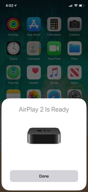

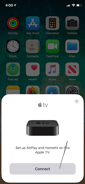

When I do this I am asked to enter the code that appears on the Apple TV. I then get -- on my phone -- a screen which reads "Set up AirPlay and HomeKit on this Apple TV." (see image 1 attached hereto) which after a few seconds is replaced by a screen whcih reads "AirPlay 2 is Ready". (see image 2 attached hereto).
With that I thought that everything worked properly BUT in the Menu Item the red badge continues to appear -- it did not go away. In addition, I have this same problem on ALL THREE of my Apple TVs.
