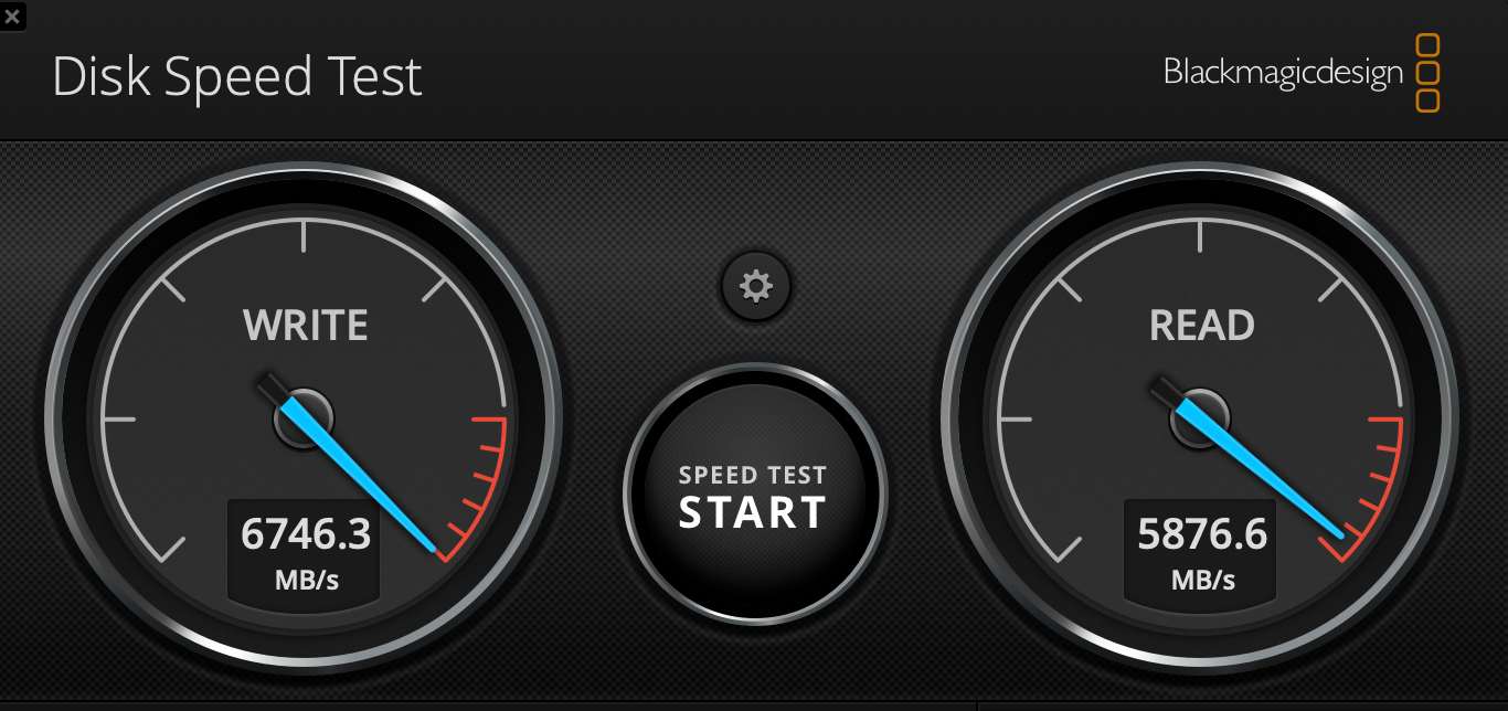

And this has nothing to do with my Mac or the Apple TV. Both are connected to the router using almost brand new high quality cables. The computer is a brand new Mac Studio Ultra with a 4 TB internal drive that has a speed of 6 GBps. The router is a Motorola MG7550 with Gigabit Ethernet.

But that's just file transfer. If we talk about video streaming to a device, before I tried this, my setup was Kodi from either the PC or the far far slower 2015 iMac I had before the Mac Studio, and an Nvidia Shield TV, the cylinder one, also connected by ethernet, and I never had buffering problems at all. Same cables and everything. So that's the obvious proof that this is not my network (and I wouldn't mind admitting if it was and change whatever needs to be changed), but if video can stream perfectly from a PC with a 130 Megabytes per second mechanical drive, you would think that it would have zero problem streaming from a Mac that reaches almost 6 Gigabytes per second:
