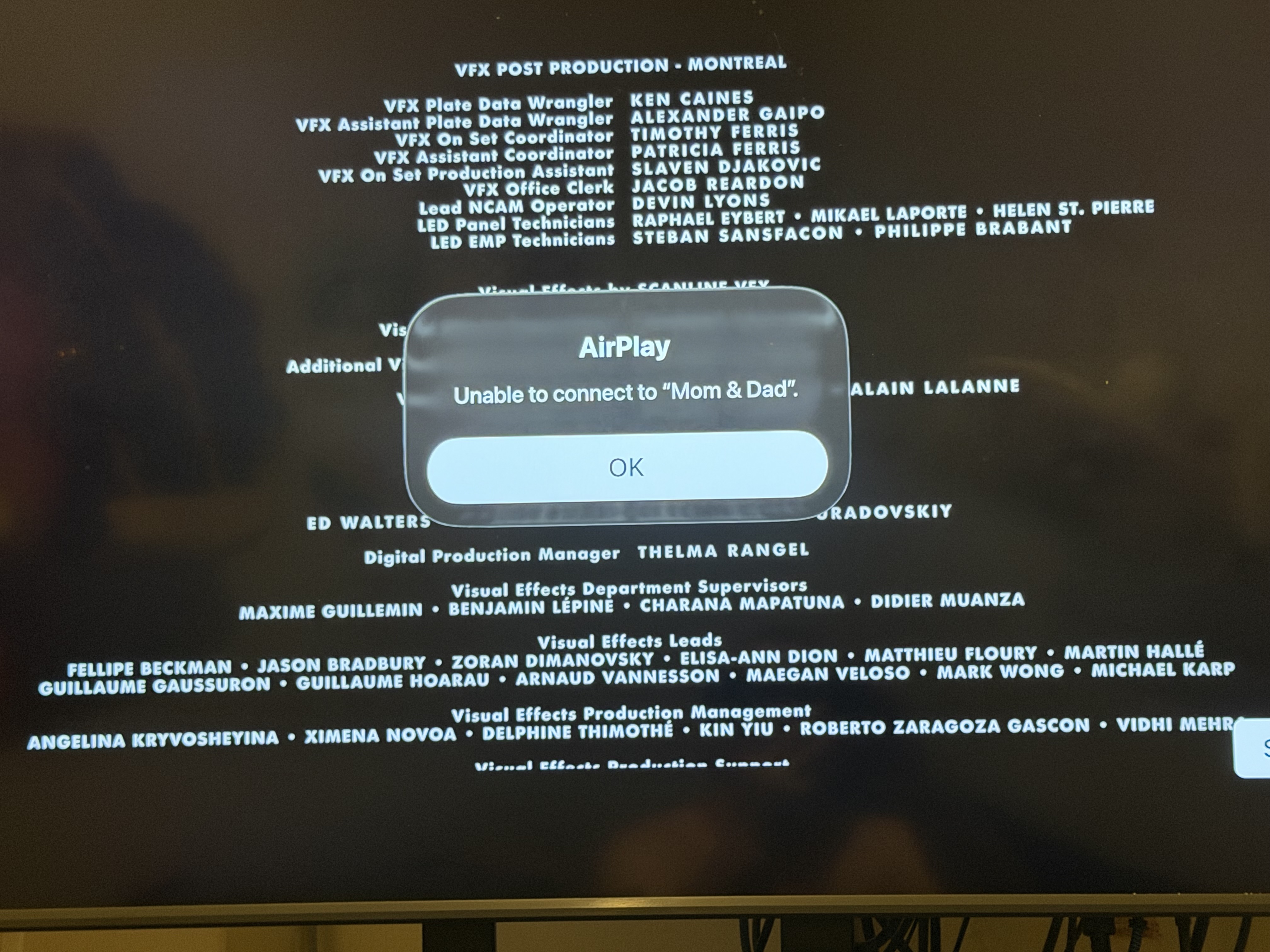

So tvOS 27 Beta 1 no issues and then beta 2 no issues for almost a week and then starting yesterday. Both of my AppleTV’s running tvOS 27 Beta 2 keep getting this “unable to connect” error. And hit okay just comes back.. Only way to temporarily fix it is to Unplug and replug back in (aka restart) the AppleTV.
Anyone else having this issue? Any way to fix it? Submitted a Feedback Report with Apple.
Guess hope be fixed in the Beta 3 or even when HomePod OS 27 comes out whenever that is. IMG_3324.jpeg
I’m seeing this too. The root cause seems to be some sort of network issue, the AppleTV flaps on the network for about 3 minutes every 15 minutes or so. In between those spasms the device works normally.
It doesn’t seem to be a memory leak. And the sudden on set is odd, my timeframe roughly lines up with yours. I’m think something on Apple’s side or a server side resource it’s choking on. From the behaviour at the Home Screen I’m not sure it isn’t the AppleTV preview video.

Saw this situation last night. I unplugged the ATV from both power and HDMI for minutes. That seemed to have worked. Then, the ATV turned ON itself and the TV -- twice. Ethernet used for nextwork.
Looked again. Same “unable to connect” error is back.
Ya what I did and also using Ethernet for networking…. But it will go away while I am actively using tv/watching the tv…. But if leave it alone for a while and come back I get it again… So like all day be watching tv in livingroom and then go to bedroom and turn on tv and immediately get this error and restart everything and will work fine until I go to bed and turn everything off then wake up error again…. Then go to livingroom and error again.

Yes, same issue for the last week or so. Tried all the remedies mentioned to no avail.
Thought it might have been my phone with AirPlay interference. Nope!
Also, having audio breakup on some programs, especially YouTube.
Was having this exact same problem, with the audio dropouts too.
What seems to have helped is turning off AirPlay in the settings as a temporary fix.
Hope they get round to correcting this in the third beta.
Same error message here but only on one of my Apple TV boxes. I have to reset it from the remote every time I switch to the Apple TV box input. Hold down back and TV button together for those that don’t want to unplug their box every time.
Also, Sonos speakers here, not HomePods but same error message.
Started for me yesterday when I updated to tvOS 27 build 24J5315i. Happens to both of my AppleTVs. One has a Sonos soundbar, the other just uses the TV speakers. HomeKit seems flaky too, timed automations (turn off the light after it’s been on for 10 min) constantly fail. I have to turn off lights manually, like an animal!
I've been experiencing this exact problem for the past few days. On the Apple TV, you probably need to disable AirPlay. On my iPhone, in the Home app, I changed the home hub to the HomePod. I then created a new room and moved the HomePod into that room, which seems to dissociate it from the Apple TV. When I move the HomePod back into the same room as the Apple TV, it prompts me to pair it with the Apple TV again. For now, I'm leaving it in the new room and not pairing it with the Apple TV until this issue is resolved. I can still use the HomePod for Siri requests, but it's no longer paired with the Apple TV. At this point, I'm still not sure whether this will temporarily resolve the problem.
After 24 hours with this configuration, it doesn’t seem to have fixed the issue. The message came back.
Last night, I didn’t get the error message anymore. Either my changes fixed the bug, or Apple worked on the issue remotely.
The AirPlay notifications have stopped. I’m not sure it was anything I did or something Apple was able to change with the service.
The only setting I changed was to manually select a HomePod that isn’t running an os27 beta for the Home Hub.
The change hasn’t affected the new os27 HomeKit notifications and other features on my other os27 devices but I’m glad to say HomeKit reliability is back to normal.
