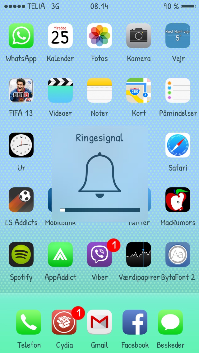

Can't you just turn the ringer volume all the way down?
Actually, no. It will only go down to one white bar. Like this. ^^

Yep, it sucks because in the past I believe it has muted not sure why it was removed
No idea why but it goes down to mute for me for iOS 7 (don't have any tweak that changes the behavior of my volume button)
I do remember in iOS 6, it would go down to one bar like that screenshot
