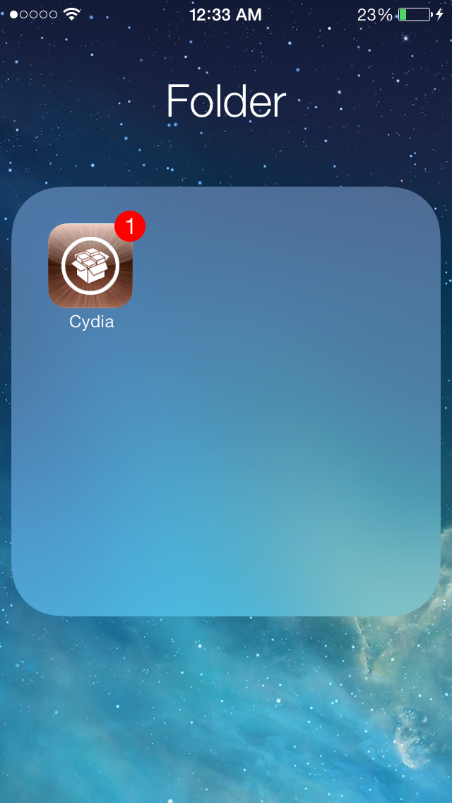

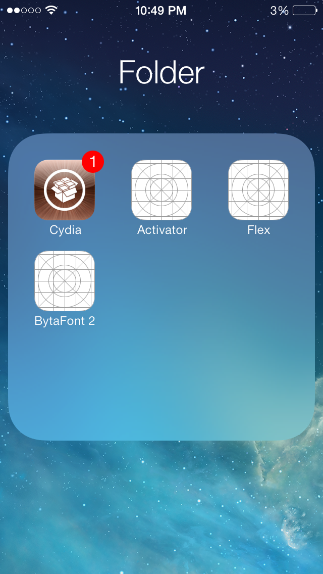

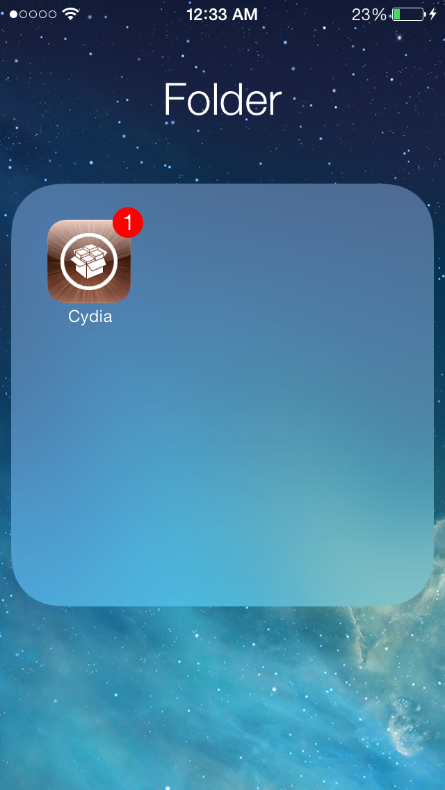

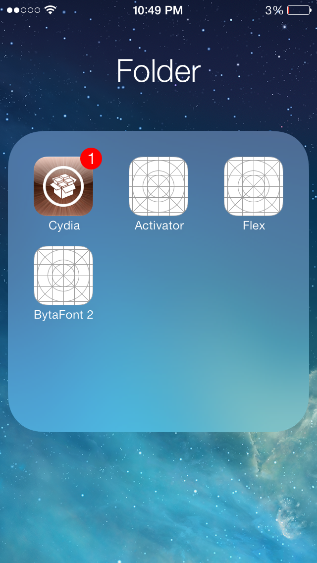

Been looking this up but it only lead me to pre iOS7 situations.
I really hope my search didn't fail as I didn't see it mentioned yet
But... my tweaks started disappearing. This happened twice already.
I was currently trying to drain out my batteries so i can do a full charge, then this happened. (refer to 1st pic)
After the phone died, and it booted up, it disappeared. (refer to second picture). I cannot find it anywhere, even through the 'spotlight'. The tweak says it's currently installed, and activator is accessible through the Settings.app, but Flex and Bytafont I cannot. This is a bit annoying honestly.
Anyone else having this issue?

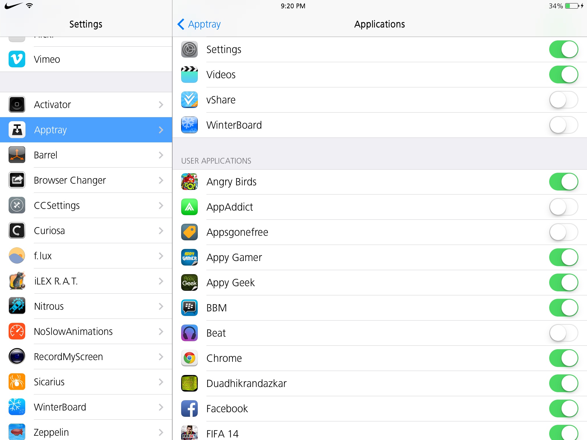

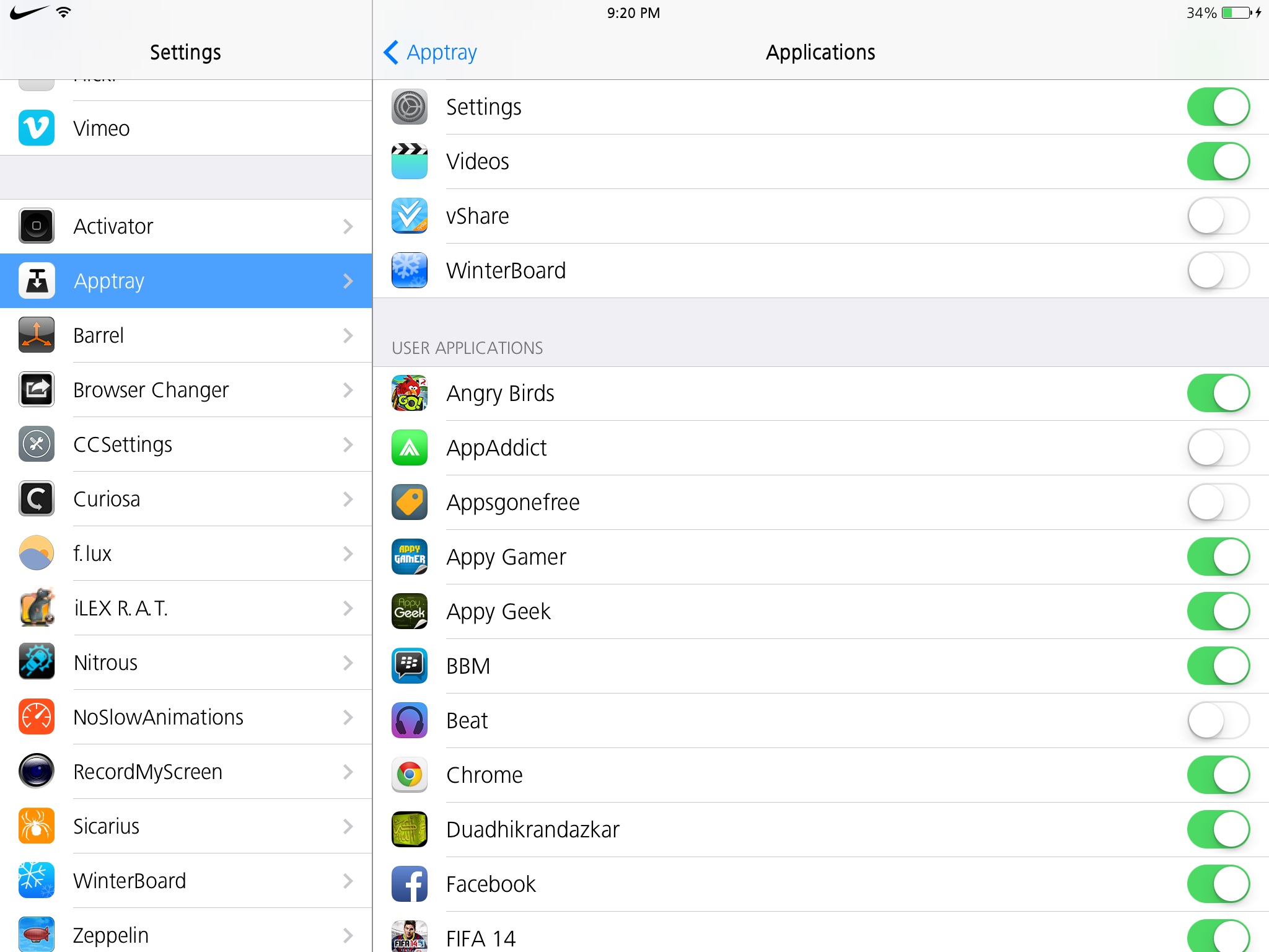

Cydia icon & Tweaks become hidden
I experience almost the same thing...my own goes like tis:
After updating 3G unristrictor,my cydia icon & tweaks disappears but I can see them in the settings app,I was lucky to have already install apptray from cydia which I can access from the notification menu.i just added the cydia and all the apps I downloaded from cydia......pls if anybody is having a solution to this then help us image.jpg
