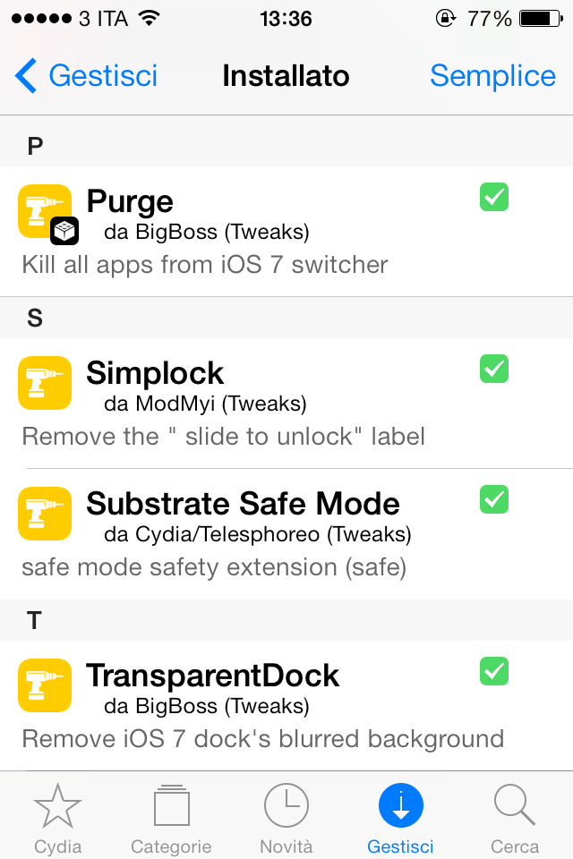

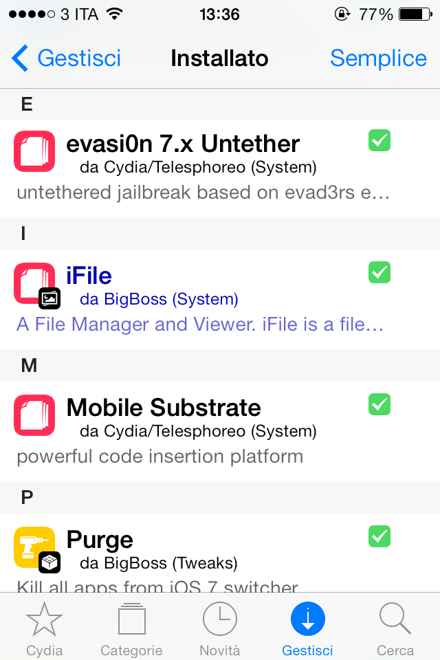

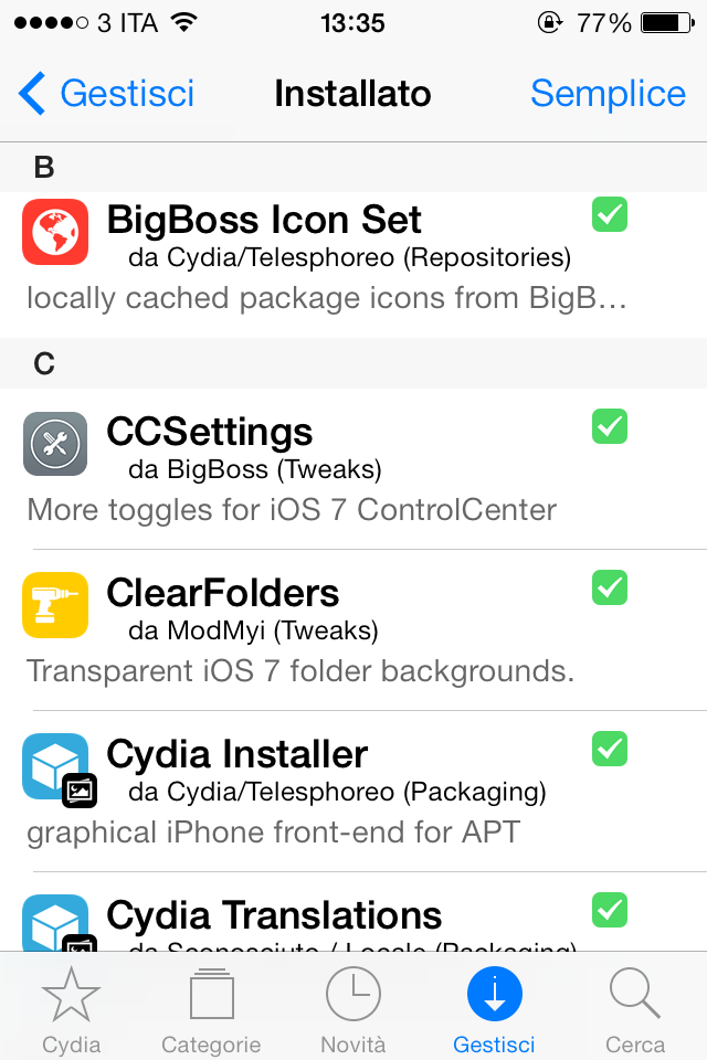

Here's the list of what I've installed. Just a couple of tweaks. When I rebooted the phone none of them is working. Can't figure why.
This is happening on both my devices, 4S and iPad 3.
