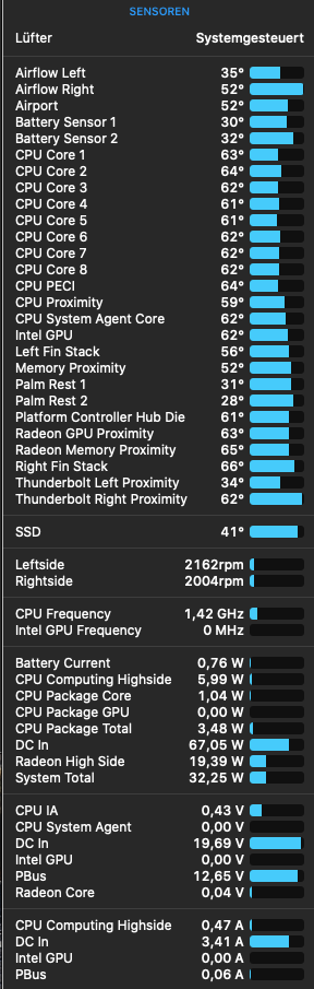

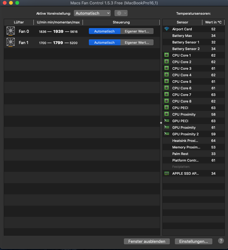

I got my 16" MacBook Pro (2.4 i9; 8gb 5500M; 64gb of ram) two days ago. Before I was using a six year old 15" MBP, which never had any problems temperature wise.
When I use the MacBook the normal way (opened, without being connected to anything) in university I get really nice low temperatures around 30 degree (=86 °F), which is even lower than my older Macbook. Strangely, at least when it's quit the fans still seem audible sometimes.
Now when I come home, I connect my MacBook to this HUB; which itself is connected to a 144 hz; 1080p screen, my keyboard and my mouse. Since I don't work on two displays the laptop sits closed (clamshell mode) on my desk when connected.
The whole time the 16" MBP is connected in clamshell mode - the temperature doubles. It's now sitting on constant 63 degrees (145 °F). The fans are audible the whole time, which ist especially annoying, since I sit near the MacBook and ist like some constant background noise.
My old Macbook never had any real difference between clamshell and normal use. It was connected to the same display, mouse and keyboard. The only real difference is, that my old docking station was active (with its own power source) - but I don't really now if that's explains the difference in doubling the temperature.
The picture shows the temp. in clamshell mode, will maybe edit later for "open" mode (but its simply the same values divided by two)

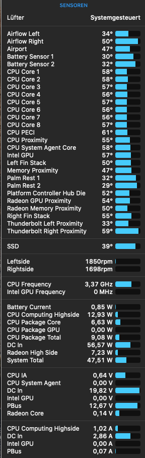

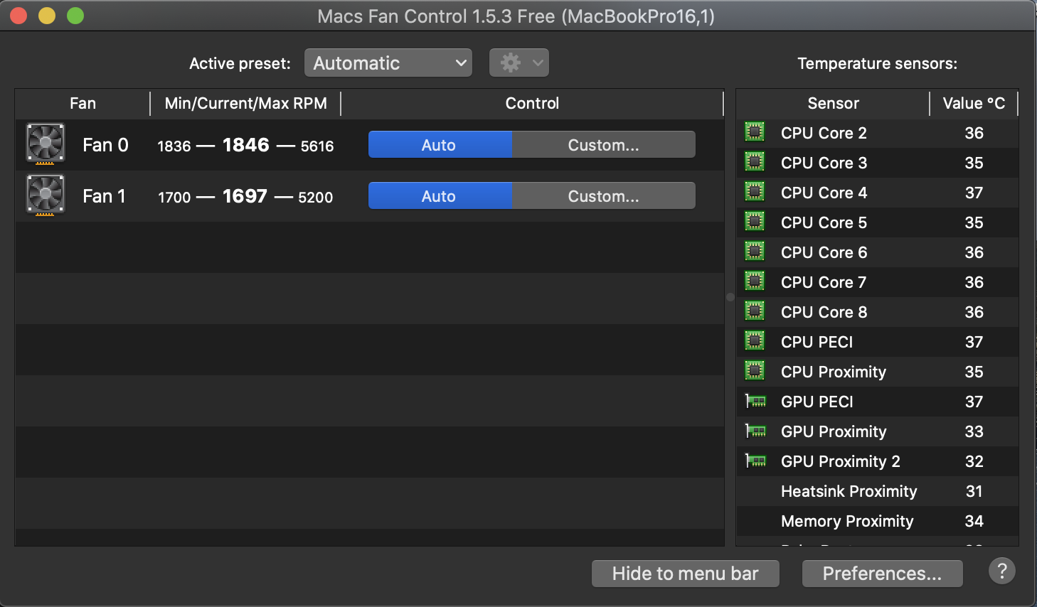

This was the temperature when having the hub connected but the MacBook open. The fans were a lot slower, but temperature was still around 63 degree. (Still double of what I get when no HUB connected)
- Sadly I can't connect my screen and the peripherals without the hub, since I don't own fitting dongles for this.

I think the reason of high temperature is not the clamshell mode, but an external monitor.
With any connected monitor MBP always switches to Radeon GPU, which consumes much more power than integrated Intel GPU, so it makes the laptop much warmer.
Would explain it.This picture shows the temperature without clamshell and peripherals connected. The GPU is a lot cooler, but also the CPU are "half as cool" which is strange.
these temperatures are normal while connected to an external display. you know the computer is rated to get much hotter than this...
Yeah, I'm not concerned for my computer (the battery stays at comfortable 30 degree), its just annoying because when at home I always work with a Display, keyboard etc. connected. Also my six year old Macbook is capable of staying quite when I used it the same way.

Very interesting. I did a PRAM/NVRAM Reset and a SMC reset on the machine. Now it is much more silent.
I am using it docked to a Caldigit TS3+ Dock and a 4K Monitor.
The temperature in clamshell and non clamshell do not differ a lot, here are some screenshots.
Left image is the laptop in opened state, the right image is in clamshell mode.
There is not a significant difference in my case. I am really starting to like this machine a lot.
When the popping sound issue is really solved with Catalina10.15.2 then I am completely satisfied :)
These results obviously are not longterm results. But based on that I will not return the machine, I had already contacted Apple and they told me to send the Macbook back via Amazon where I bought it via a black friday deal, that should not be necesary anymore :)
