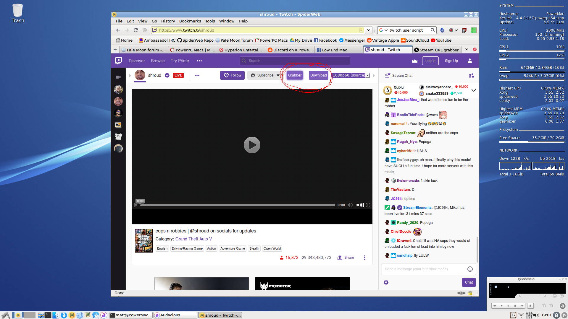

First, using a mozilla derived browser (TFF, AF, IW, SW, PM etc) install the GreaseMonkey extension. Then go grab this user script: https://greasyfork.org/en/scripts/8114-stream-url-grabber and install it.
Then load up twitch.tv in your browser. Give it some time to load. Our PPC's aren't always speed demons. Once you find a stream you want to see click on the "Grabber" button, then click on the "Download" button that pops up next to the Grabber button. Save the m3u8 file.

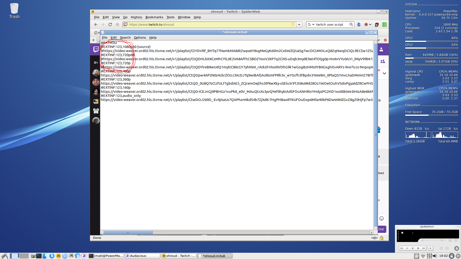

Open downloaded blahblah.m3u8 file in any text editor and comment out # the higher resolutions. I find 480p is a happy medium for me without taxing the cpu.
Now right click on blahblah.m3u8 and open with your favorite video player. I use mpv, but vlc and mplayer work just as well. Boom! Your stream will start playing. Enjoy. 😉

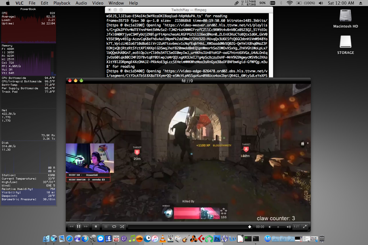

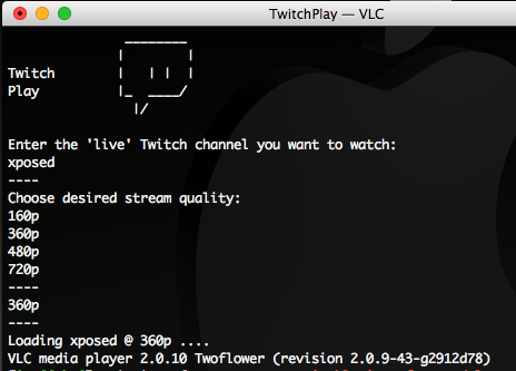

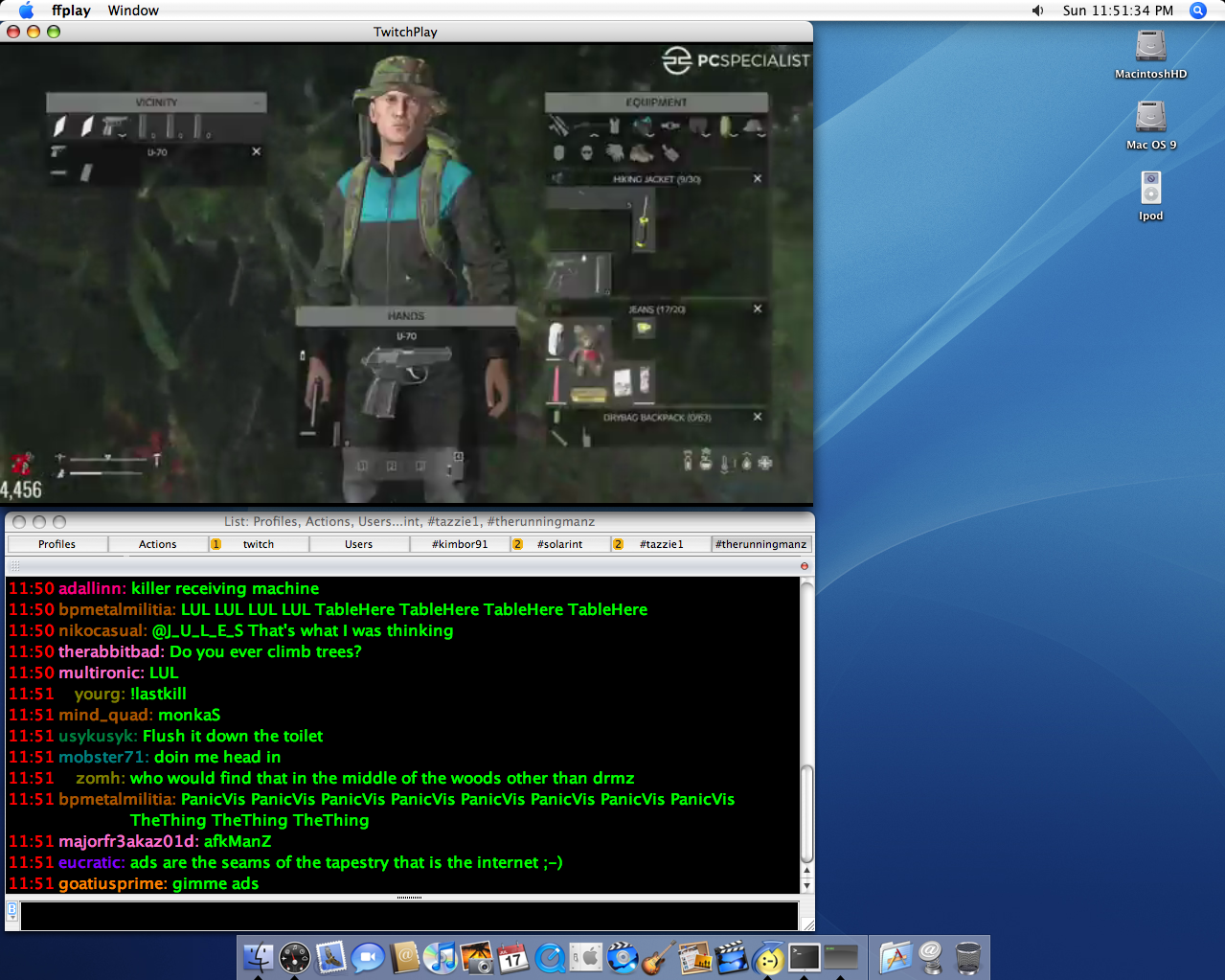

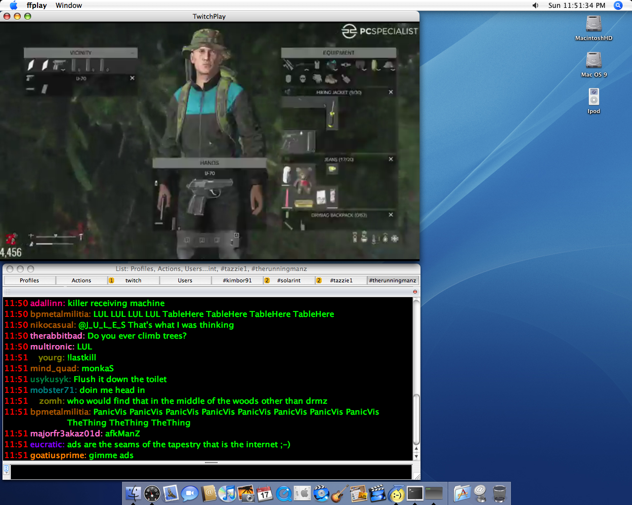

Ok, so the previous way kind of sucked, and didn't work with any 10.4/10.5 browsers, so i created an app/script to make it easy. This is tested and working on Leopard. It may work on 10.4 if you edit the script to use mplayer. By default VLC is used as it starts the stream instantly, while mplayer takes a good 20-30 seconds to play.
Requirements: Current youtube-dl, FFmpeg from macports (does the smtube mplayer.pkg include it?), VLC 2.0.10 or higher, and OS X 10.5 or higher (10.4 is untested).
480p fluctuates 60-90% cpu on PowerBook G4. 360p sits around 53%.

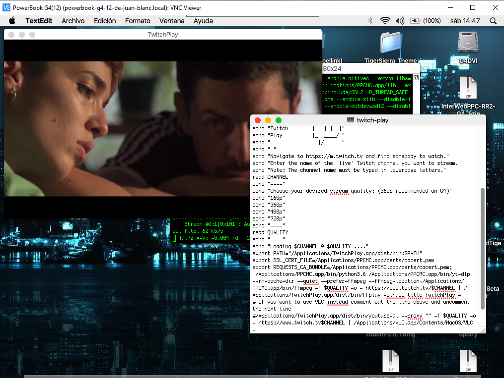

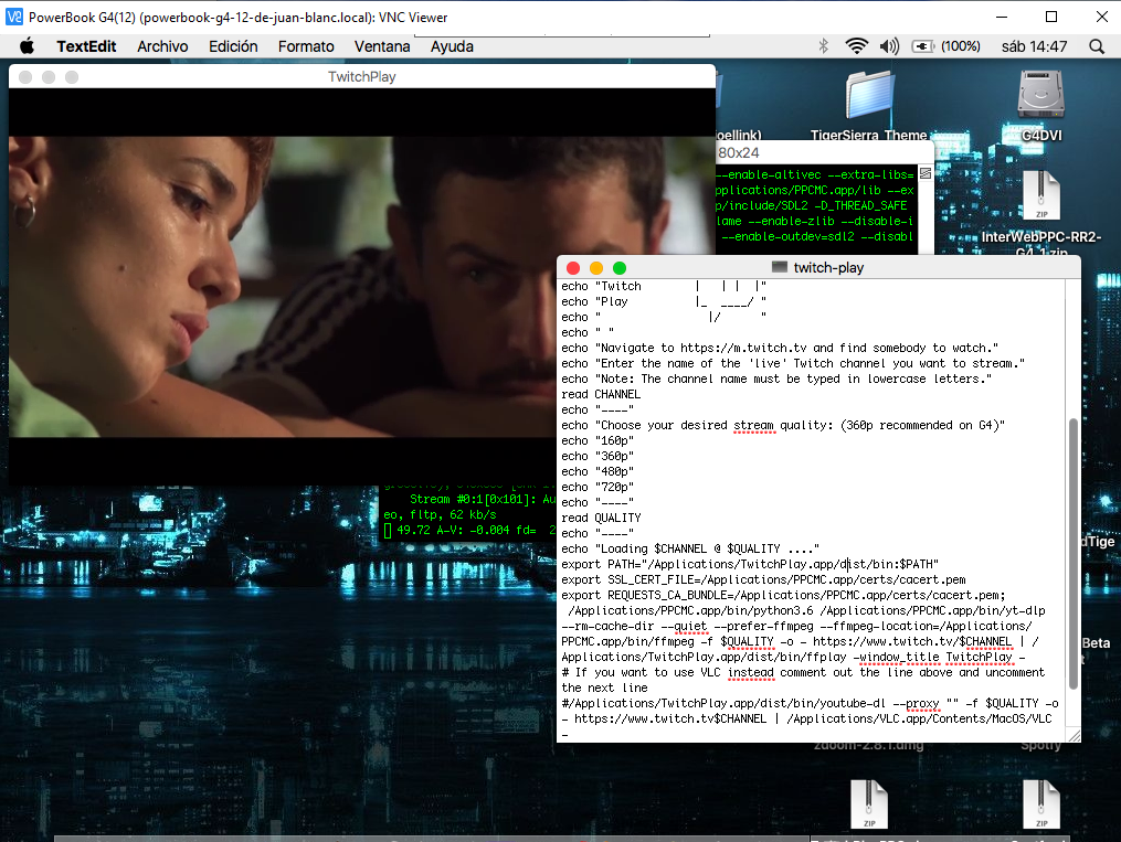

So I got an idea.. if you switch youtube-dl and use yt-dlp (From PPMC) you can still use the app.
I have edited twitch-play script (added some certs) and I was able to bypass the error
Also disabled some debug info from yt-dlp ffmpeg
I attached the modded twitch-play script, download and replace it under /Applications/TwitchPlay.app/dist/bin and you are ready to go

Exactly, it will look for yt-dlp, ffmpeg and python3.6 from PPMC folder.. Glad it worked 🙂
I tested it on my G4 12" 1ghz DVI and I was able to play streams up to 480p, highly recommed to install brew for tiger (tigerbrew) if you want to play around with the OS

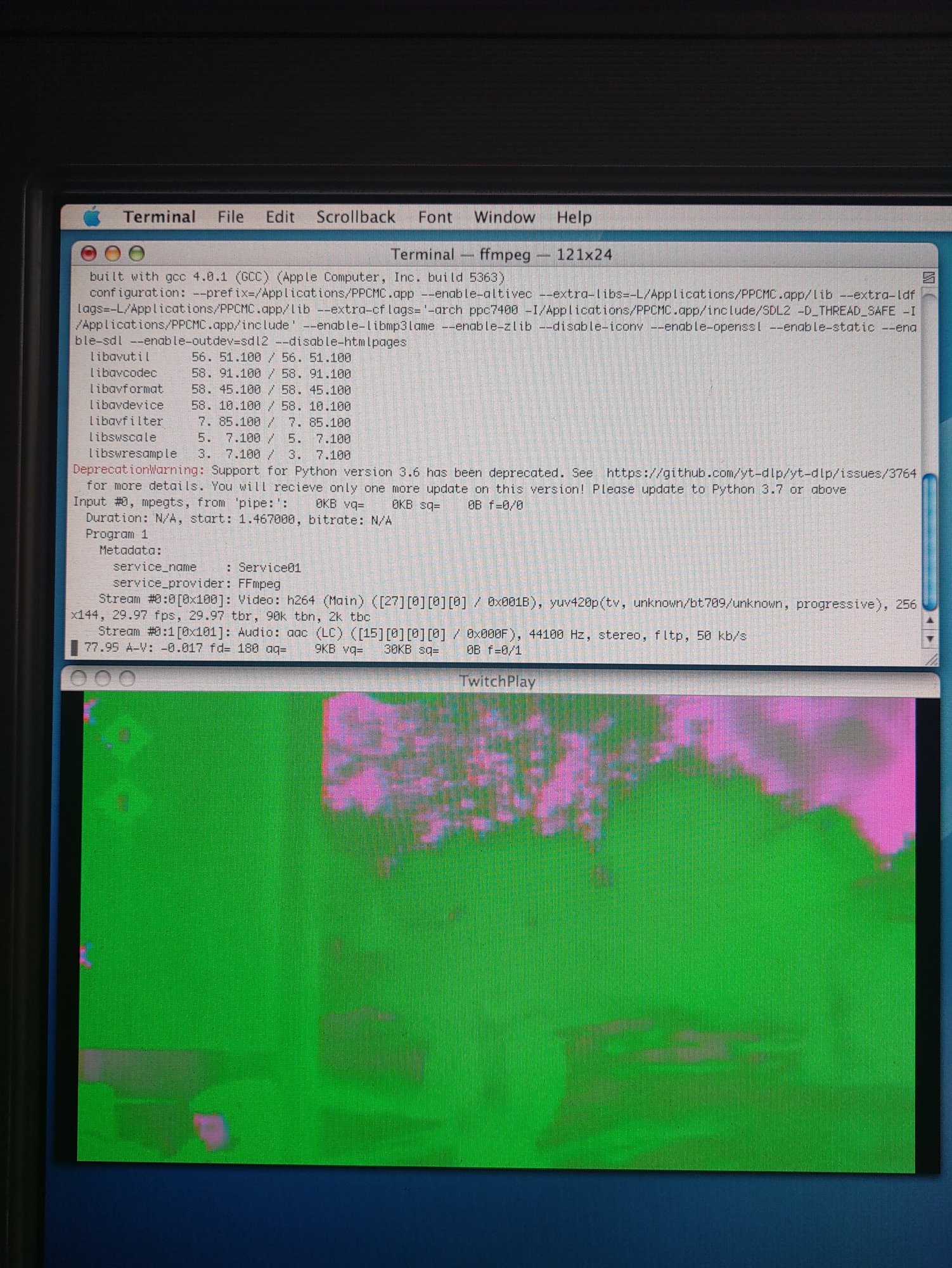

Thank you Dronecatcher. That got it up and running but still getting the green & pink. Tried swapping a few files with ppc media but no luck. Works fine on ppcmc. Thanks for the help.

Adding this for FFPlay should fix the colours:
ffplay -vf scale=in_color_matrix=yuva420p,format=rgb32
I'm taking this from my youtube scripts so haven't tested it for the Twitch stuff - as I'm not a "Twitcher" 😀
