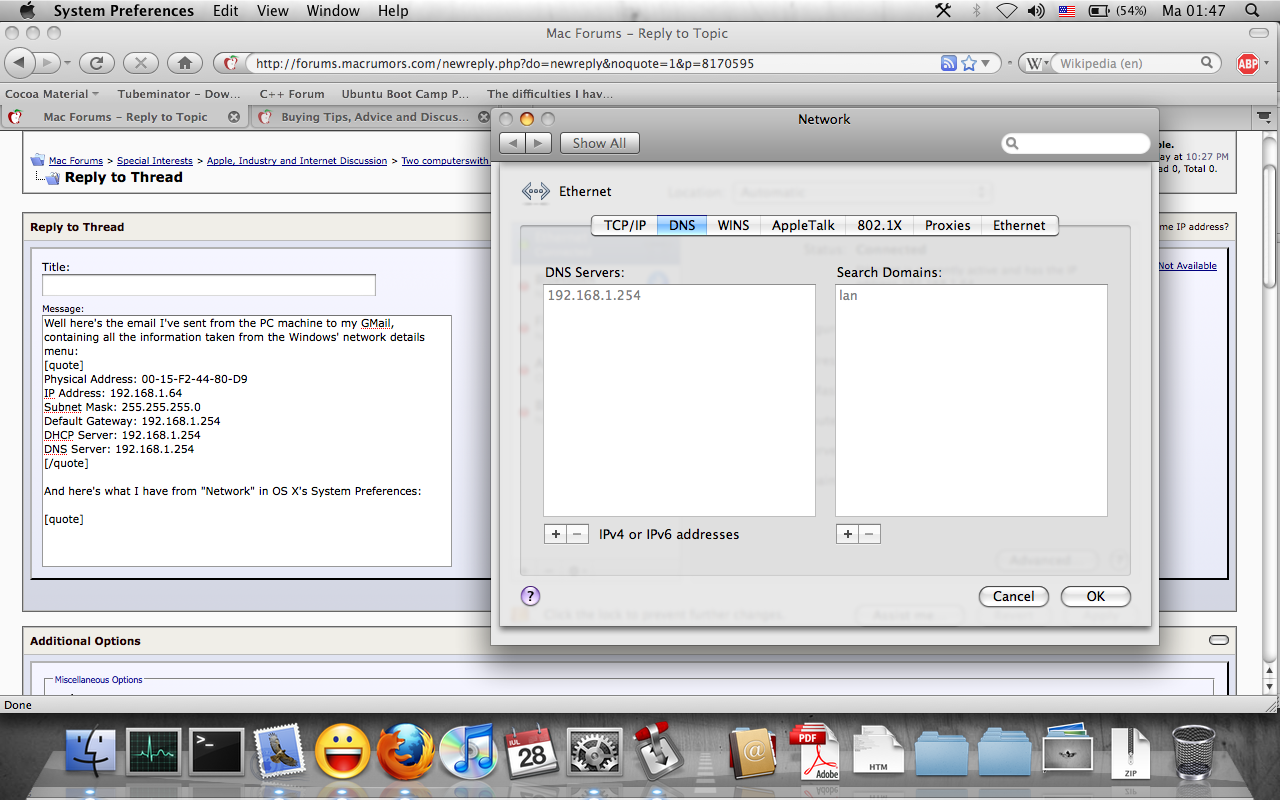

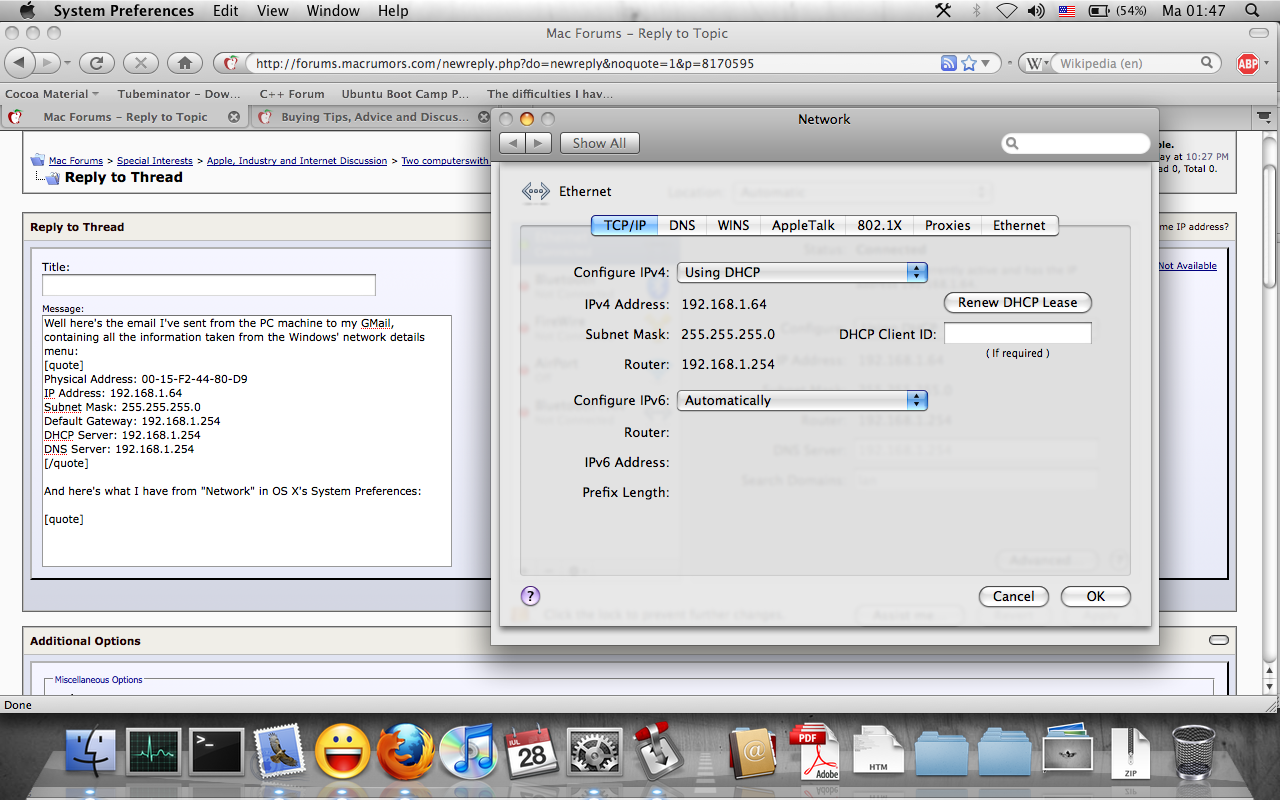

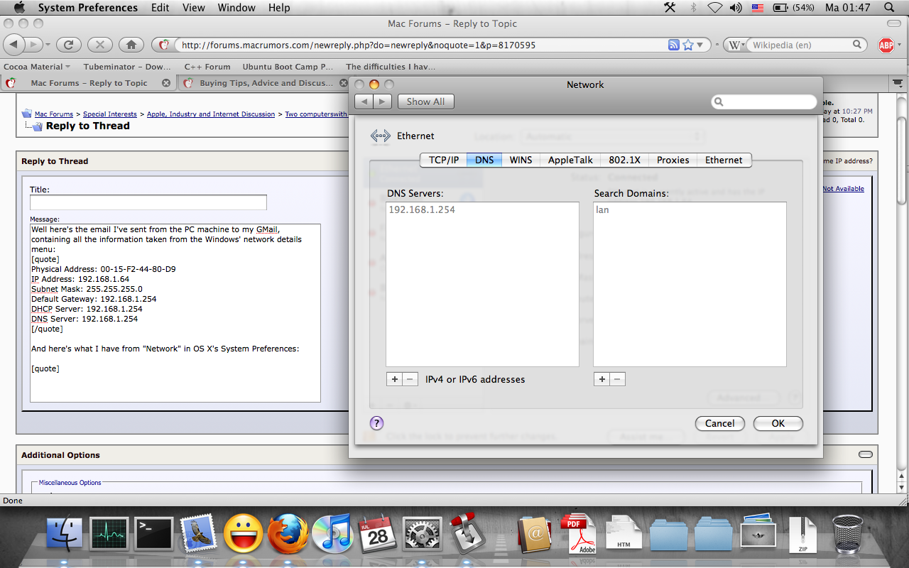

And here's what I have from "Network" in OS X's System Preferences:

You're using the internal IP address that I was talking about, they are not part of the global Internet network. You are getting an internal ip address assigned by DHCP server inside your modem. It is not the same network as the other location, the other location is a different internal private network that has it own 192.x.x.x address space.
Two modems, two private internal networks, both PCs can have the same IP address because they are not in the same network.
OP, refer to my previous post.
To check your actuall IP address that is connected to the internet (your external IP address) go to www.ipchicken.com
Using the Run command on a PC and typing in the ipconfig is just showing your local address. The same applys to when you are looking at the networking preferences in System Preferences on a mac.
