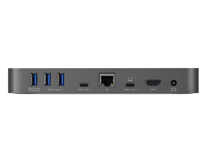

I have 2 solutions that work well for me. The HooToo Shuttle supports 3 USB 3.0 drives along with HDMI and passthrough charing power via USB-C. Plug the charger into the Shuttle and then the Shuttle into the MB12.
The second is the OWC USB-C dock. I'm really like it for both my MB12 (still contemplating selling it) and my MBP13 (2016). It's the most powerful of the two. I've had 4 USB 3.0 drives as well as 1 USB-C SSD connected to it - all via the single USB-C cable. Plus it has an SD card reader, audio out and HDMI. I run multiple backups with it via Carbon Copy Cloner without issue. The dock has been great for the 2 weeks I've had it.

When on my desk, I use the OWC USB-C dock and love it which HAS a USB-C connection as well (my external USB-C SSD drive connects to it without issue). I have not found a "portable" solution for this. I used it with my 12" 2016 and now my 13" MBP. It hasn't had any issues and all of the ports are full of drives (4TB USB 3.0 x 2, 1TB USB 3.0 x 2 + 1 525G SSD USB-C) and they are all running on Carbon Copy Cloner tasks daily. No errors. The SD card reader is great. I don't use the HDMI (I tested with an old monitor and it works) as I have the 4K LG USB-C monitor.
https://eshop.macsales.com/shop/usb-c/owc/usb-c-dock

One thing to note about the OWC, to get the ethernet to work, you need to download and install a driver from OWC. They state it's not needed or recommended for 10.12.2, but it IS Needed based on my personal experience. Once installed, you have ethernet. It passes through my 120-130 mbps broadband just fine. The driver is located on their page about the dock, here is the direct link: Ethernet driver required for OS X 10.10 and 10.11 only (found on this page: https://eshop.macsales.com/item/OWC/TCDOCK11PSG/)

I have finally bitten the bullet and bought the proper solution for connecting multiple drives to a MacBook.
http://www.caldigit.com/usb-3-1-usb-c-dock/
The OWC equivalent which kwandrews has (post #12) would probably have just done just as well, but not as readily available in the UK. (The OWC looks nicer IMO and has an SD slot. Both need a driver for ethernet).
Now I can connect three external SSDs, boot from one of them and copy data at full USB 3 speed between the other two.
However no way is the Caldigit a portable device, so the Hootoo still has a place in my bag for its much more limited capabilities.
I wish I had done this the day I bought my MacBook last year.
I suppose it is obvious that 29W suppled to the Hootoo to charge the MacBook and power three ports, was not going match the 90W of the Caldigit to charge the MacBook and power four USB ports.

Just a brief follow up to the above. After a while I noticed that drives connected to one of the ports (actually the USB-C one on the back of the Caldigit) frequently didn't mount. Connecting using the USB-A ports to my USB-C Samsung T3 drives was fine. Although I could manage perfectly well without using that port I don't like gear which is slightly faulty so returned it and bought an OWC USB-C dock instead.
I put the OWC through the same torture test I had done on the Caldigit, that is connecting three SSDs to the hub, booting from one of them and then transferring 100Gb data between the other two. The Caldigit passed this with flying colours, but OWC stopped and started and paused, and then unmounted the drives. The OWC would transfer the data fine between the other SSD and the internal drive, while booted from an external. It also transfers data fine between two externals while booted from the internal, just not between two externals while booted from a third external.
I suspect this is a design limitation of the OWC rather than a fault, and it is something I would never need to do in practice. As I much prefer the OWC in other ways I have decided to keep the OWC.
UPDATE: I have repeated the "torture" test about a dozen times since that first event, and it has not repeated. There is sometimes a pause after transferring a few GB of data, but if left a few seconds it resumes smoothly to completion. No spurious drive ejections. Maybe the Caldigit also paused while I wasn't looking.
After a month with the OWC I have returned it and bought a second Caldigit. The problems which emerged with the OWC were:
1. During a normal T3 SSD to T3 SSD transfer it paused and then ejected the disks improperly. This is the second time it has happened, the first time being during the torture test.
2. When you plug in the power cable to the non-running MacBook it gives a chime and shows the green battery symbol once. With the OWC it carries on chiming every few seconds until the machine is booted. This does not happen with the Apple charger or the Caldigit. Minor but annoying.
The second Caldigit has the same "fault" as the first one so now I have to call it a "characteristic". T3 SSD drives connected to the single USB-C port on the back need to be connected the right way up. This makes no sense to me as the USB-C plugs are supposed to be reversible and are in all situations I have come across except this one. As long as I connect the T3 the right way up it connects and mounts straightaway. I have tried different leads and different T3s with same result. All completely repeatable.
I talked to OWC Support who thought my "torture" test was probably beyond spec but were concerned about the unmounting disk incidents. Maybe my OWC was faulty, but after the second unmounting incident, I decided to return it to Amazon as I was within my return window, rather than get an exchange from OWC.
I have the feeling the Caldigit is the more capable unit, but it may be that the OWC I had failed the torture test because it faulty. I suspect this wasn't the reason in view of OWC Supports comment about being beyond spec. Both Caldigits passed the torture test.
