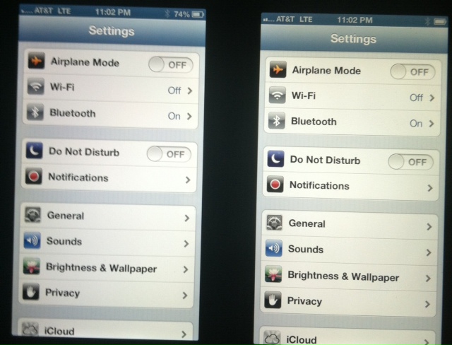

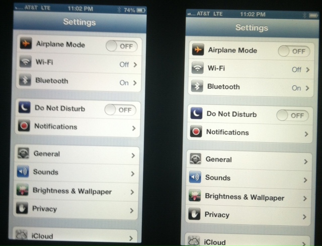

I compared the display of my iPhone 5 with another family member's. Both are at the same brightness. My iPhone (on the right side of the attached image) has a warmer display, with a very slight yellow tint. The iPhone on the left has a slightly cooler (and seemingly better) display. When I use my iPhone 5 normally, the warmer tone of the display is not very apparent... but as you can see in the image, there's a clear difference when I put the two iPhones side-by-side.
Anyway, just wanted to get some input. Individual preferences aside, am I correct in thinking that the warmer display is not as good/high quality as the cooler, more natural looking display? Some seem to think the warmer display on the iPhone 5 is normal and helps improve color saturation... not sure if that has any merit or not.

The yellow tint is absolutely not correct an you should not stand for it. This happens every year, with Apple rushing to meet manufacturing demands, and producing yellow screens. You should demand a replacement.
"Yellow tint" is simply closer to D65 screen calibration standards. My professionally calibrated theater plasma screen looks yellow next to an overblown, overblue LCD. It's a much different white point.

This. OP's screen looks normal.
(by displaymate.com) Suggestions for Apple: Keep up the good work in improving picture quality through accurate display calibration! To produce a better display please don’t make the White Point Color Temperature so blue – it’s the only significant calibration flaw and it gives some images a bit of a cold bluish caste.

These comparison shots neglect to mention what white balance settings the camera is set to. A different WB setting might make the warm one look white and the cold one look too blue.

My screen definitely looks like the left phone and is cooler. I prefer the cooler look and actually have my computer monitors set a tad cooler than the normal 6500K. But as much as I prefer the cooler look, when I take a photo with my phone and compare the color to the actual object, the photo will show cooler as well. So I bet those with e warmer screens will show photos that are more color correct.

The screen white balance is ok. What causes yellowing tint is uneven backlight from the top right corner (probably from the twisted LED). You can clearly see this portion of the screen is affected the most, while bottom left side remains practically yellow-free. The screen itself looks much better calibrataed than the one on the left side. Anyways I would exchange it due to uneveness of backlight. None of these screens are 100% free of backlight issues. Here's why:
It's actually very hard and rare to find 100% perfect screen in iDevice.

okay well the screen on the right happens to be defective however you're wrong, the iPhone 5 actually did get calibrated warmer (and the 6 probably will be more so) than previous iPhones.
