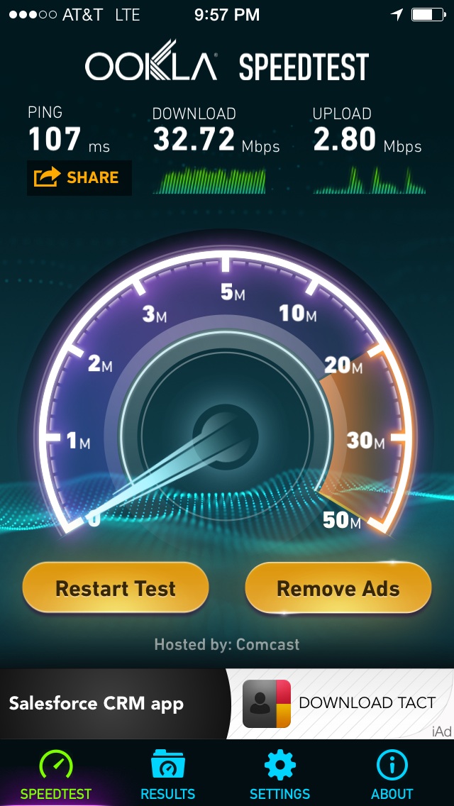

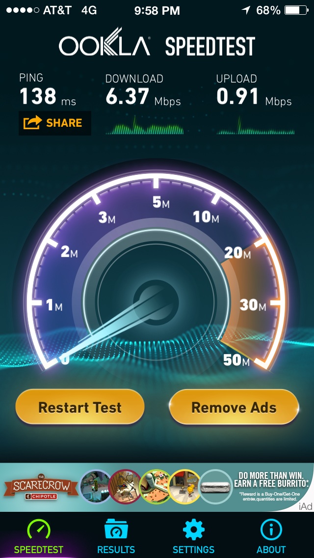

Awesome: perfect time to do a speed test.
Let us know if they come out the same/similar speed.
The LTE phone should be faster!

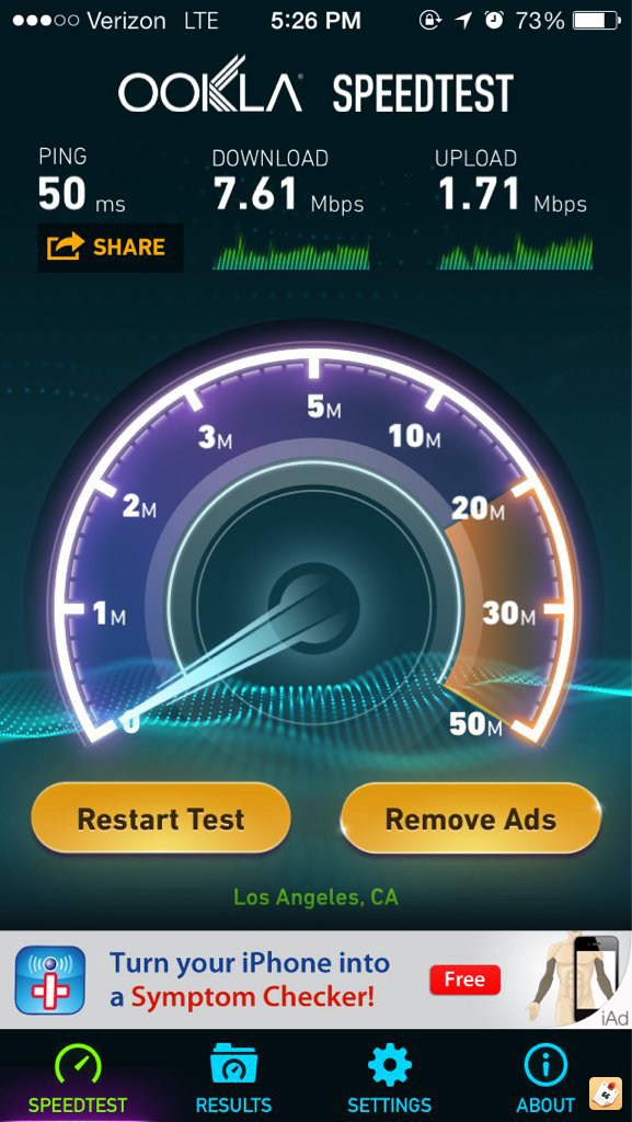

. This is my slow Azz Verizon on LTE!

Image. This is my slow Azz Verizon on LTE!
The first speed test was in my room, this one is next to a window in my room. I guess it makes a difference!
My wife's phone on LTE is faster than Comcast; and way faster than my 4G.
