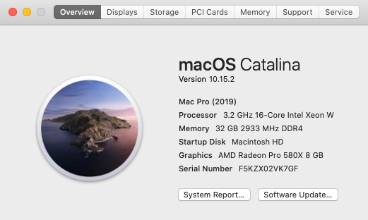

Just received my new MP a couple days ago. Upon setup I discovered two issues and curious if anyone else is experiencing. I have not called Apple Support yet, but intend to in the next few days as time allows.
Issue 1: MP will not sleep.
Restart and Shutdown work fine, but sleep does not work. Have tried from UI and command line and the behavior is the same. The computer appears to be going into sleep mode - monitors go black but the power light on the top of the MP stays solid and does not pulse to indicate sleep mode. Also worth mentioning, when monitors go black there is an audible thump from the external speakers.
Issue 2: Both monitors do not turn on when when MP is awoken from sleep mode.
When the MP is awoken from "sleep" (see above issue - MP power light is still solid) with key press or mouse click, only one monitor displays an image. If I disconnect the non-working monitor from the Thunderbolt port and reconnect, the non-working monitor works as normal. This behavior remains the same if the monitors are connected to the rear or top Thunderbolt ports. I have also tried swapping out several different monitors (LG and Dell) and the behavior remains the same so I don't believe this is a problem with the monitors.
Anyone else have these issues?
MP config: 16-core, 1TB SSD, 32GB RAM (8GB x 4 from Apple), 580X
