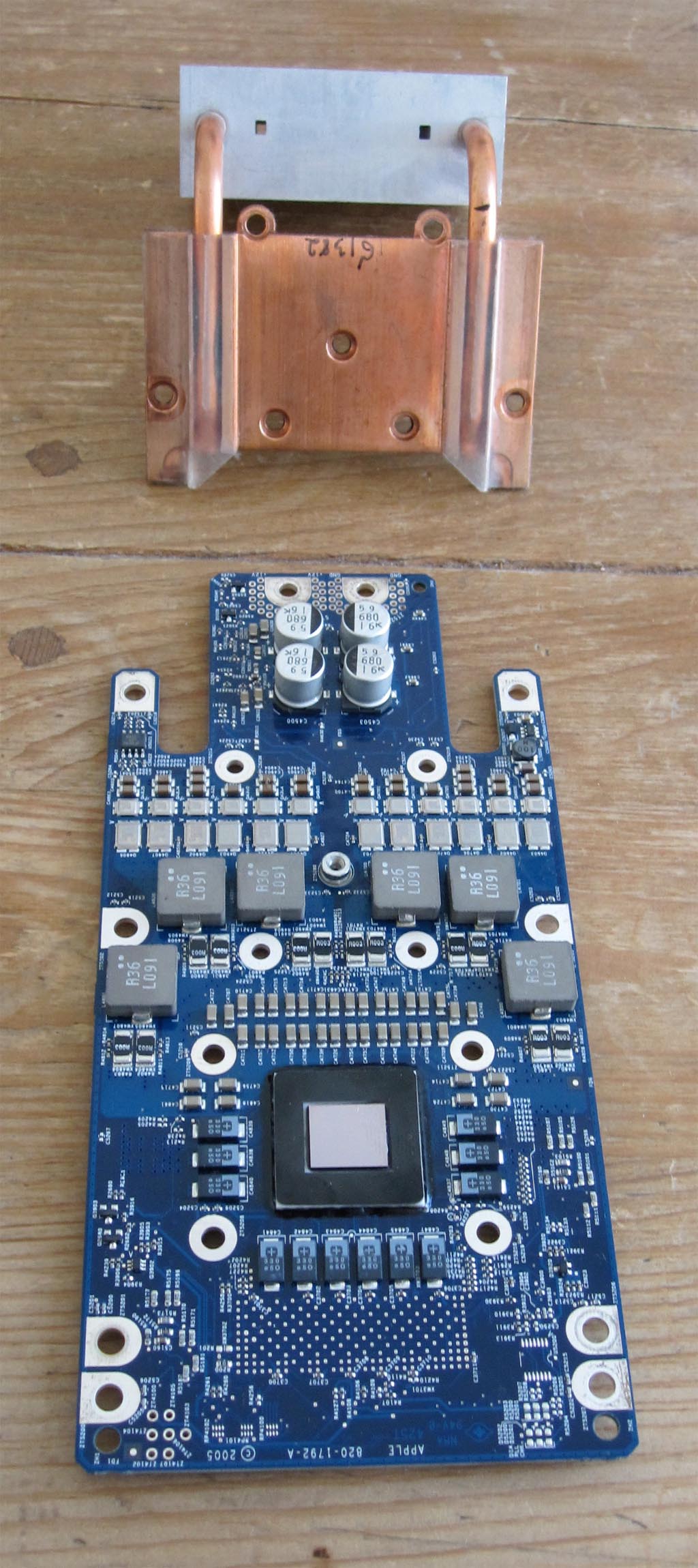

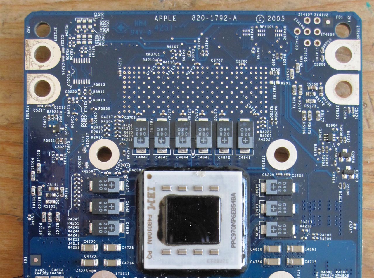

The Apple-part-number stamped on the card is 820-1792-A. Since I found out that the heatsink-fin is detachable (after a rude loosening with a flathead-screwdriver - very sticky thermal-pad), the CPU-cards seem to be interchangable between the two LCS-variants. So it must be possible to aquire a "new" CPU-Card.
A little search on google brought me across some US-auctions on ebay. One Seller is advertising a 2-GHz-Card which has the same part-number. Further digging unveiled that all Late-2005-processor-cards (I found at least some 2GHz- and 2.5Ghz-ones) seem to share the same part-number.
Could that be?
If this is true, the hard-coded frontside-bus-speed of the logic-board (1GHz for the 2GHz, 1.15 GHz for the 2.3GHz and 1.25GHz for the Quad) seems to determine the CPU-clock-speed.
Can this be true?

P.S.: Here're two photos of the CPU-card in question.

I would rebuild the machine and install a new CPU card and overhaul the LCS. There are a number of members here with parts on the Marketplace, and there was a thread by a member looking for a quad where parts were offered. Perhaps you could PM them.
