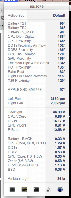

Thanks for the responses. I've tried removing/adding a bunch of software but it still seems to run really hot.
I've attached a screenshot of what's running. This is when it's mostly at rest. From what I've observed, it's always the CPU Die and GPU Die that are above 180 (and rarely go below).

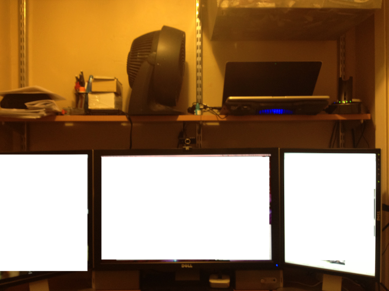

I run the three monitors as
Thunderbolt (closest to power jack) -> Dell U3011 (using mini-DP to DP cable)
Thunderbolt -> Dell 2007FP (using mini-DP to DVI converter)
HDMI -> Dell 2007FP (using HDMI to DVI converter)
My temperatures are as follows:
Right now, the reason my internal fans aren't running above 2000 is because I'm pointing a huge fan at the computer which is whisking away the ambient heat 🙂
Here's a pic of my current setup:
