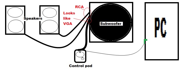

For the sake of posting, here is how everything looks. But once again thanks. So the cable iNeed is just a normal RCA splitter?

haha, no were not the same person. The same thing happened to both of us and has happened to a few others as well. Could anyone tell me the name of the connector of the control pod to the sub?
