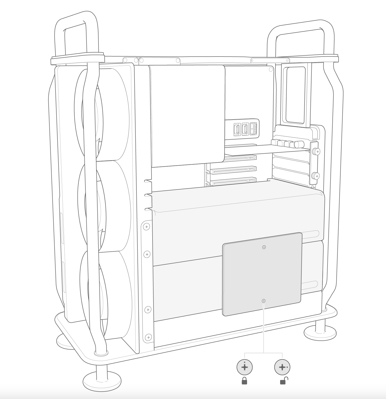

This image from the product page illustrates where the connectors are.
MW672_AV2
The connectors at the top. There is a usually something covering those ( in the top view image you don't look "down" on those. So I suspect the view above has the covering removed because there is a 'break' in the top round edge around the connector. ). That covering is probably what Apple is referring to here as the 'cap'. Apple has probably worked pretty hard to camouflage the seem where the cap fits in . The non 'blue' end of the lever, but more on the rounded edge. (if zoomed in close on the top view image there are some artifacts there to suggest a seam. )

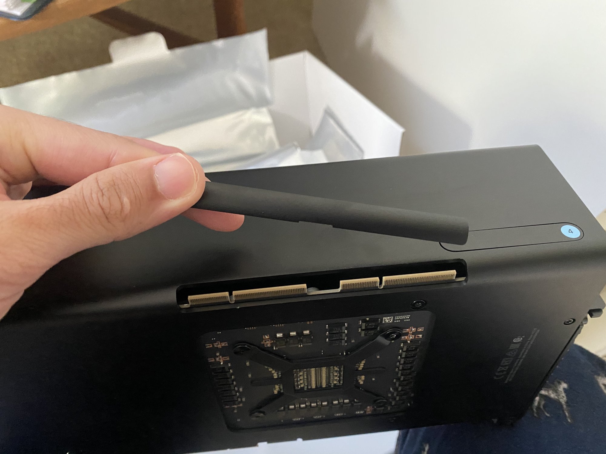

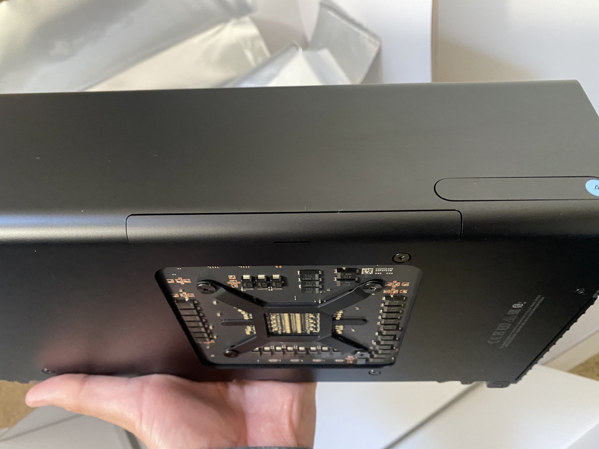

The caps refer to the black caps covering the infinity on the GPU itself. They are capped from factory. So you would need to remove gpu and take caps off. It is possible to remove them while installed in Mac but its easier to take GPU out of system to remove them.
Edit: Snapped a picture of my AMD Vega II
Thanks for this, appreciated.
