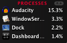

P.S. Does anyone know if WindowServer would do anything that would effect this? I often find it in the "Processes" section of my iStat widget. (See attachment).
Edit: it did it a minute ago and Safari was using 50%, and WindowServer using 13%. Maybe I should switch to FireFox, for not? Could be a Safari problem? It only ever seems to happen when Safari is open.

Well, I think Safari is my probable culprit. It just jumps up to using 50% of the processor randomly...
Either that or WindowServer
It definitely sounds like Safari is hogging the processor, which is slowing down everything else. Kind of like when you open loads of apps at once and things get delayed.
Do you notice this happening when you visit Flash-based websites?
Also, WindowServer is a normal process. It's nothing to worry about unless it too is at an unusually high percentage.

Ok thanks. Well, I've zapped the PRAM and everything seems to be safe and sound again. I think my recent escapade with trying to open 80 apps at once confused the poor the thing. Macs may be virus-proof but they're not fool-proof... sadly!
