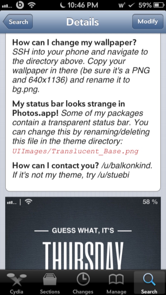

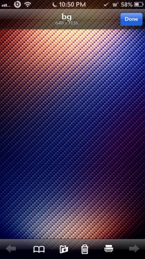

I am following the instructions.
I am getting this when i change the png file
I am trying to get this as the background.
Any help?!
Need any more info.
Sent from my iPhone 5 using Tapatalk 2
If you're using the version from his repo, the instructions are wrong. Rename the image bg.jpg instead of .png. Respring. (May need to deselect/reselect in Winterboard for the change to take effect.)

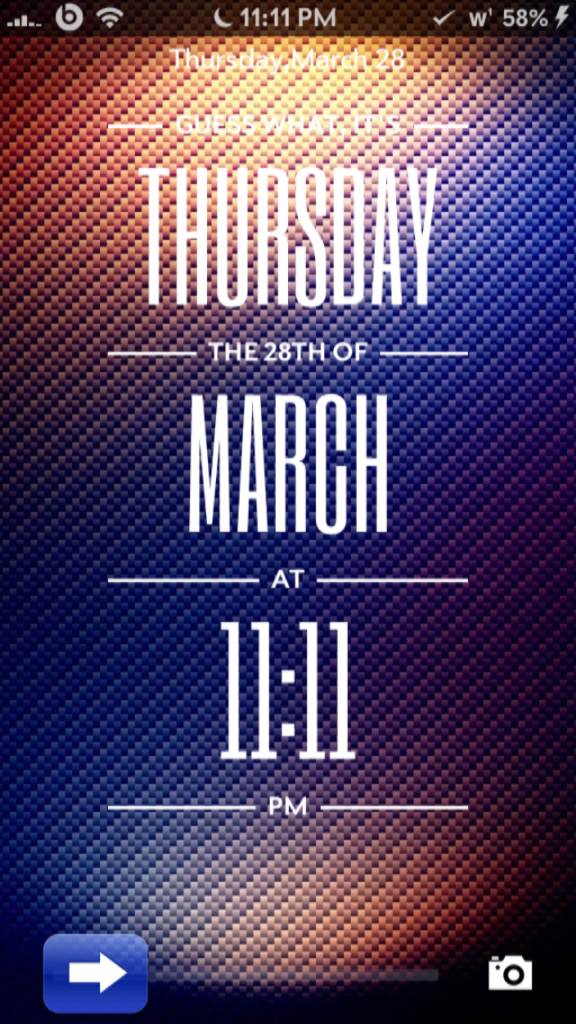

Does not look good but i learned how to change the bg thank you
Now this looks SWEET

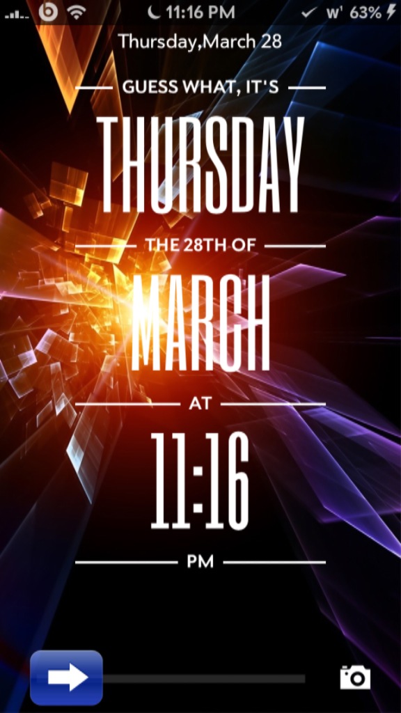

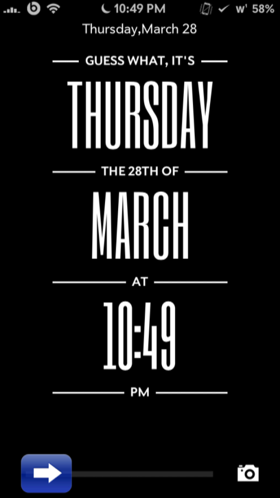

Which status bar font is in the 2nd picture?
Typo5 Lock-screen background change problem
Boxii Font

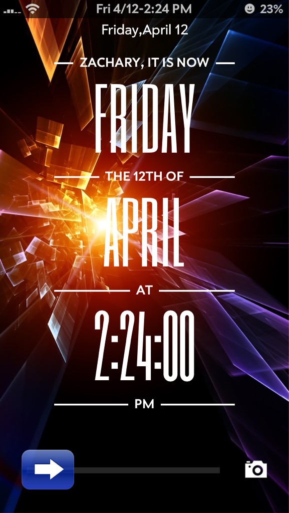

What I want to know if I can add seconds to the time!
Can i add seconds to the time. What is the authors email of typo5 so I can ask.?
Add Seconds
All the credit goes to the creator of Typo5 lock screen, and thanks to him for creating it, I have enjoyed it a lot.

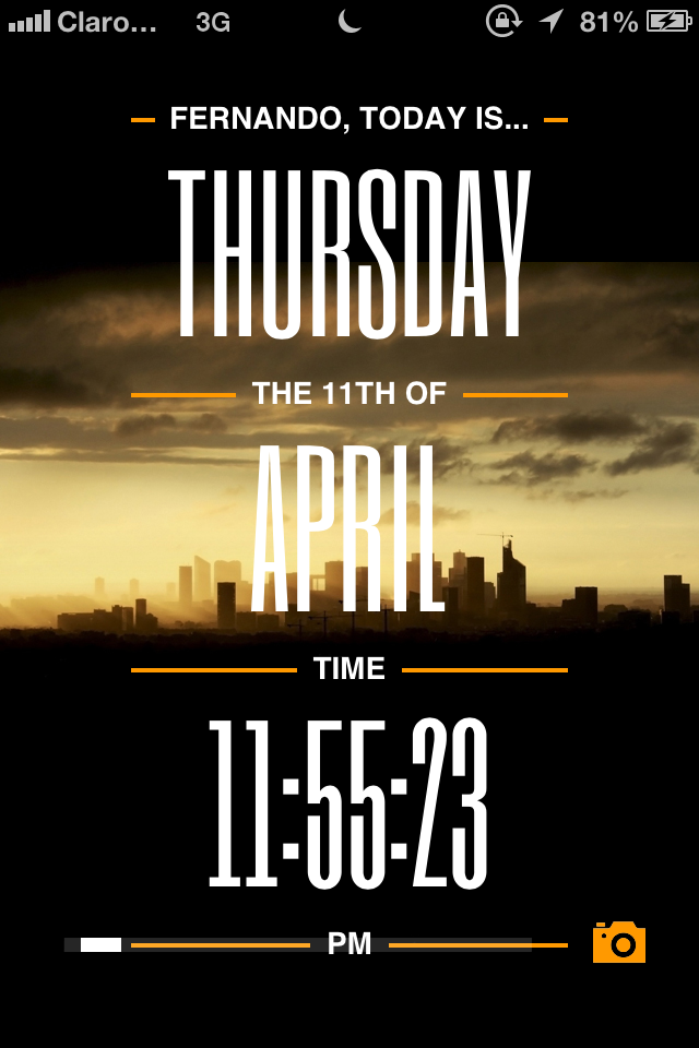

here it goes....
var hours = currentTime.getHours();
var minutes = currentTime.getMinutes();
var seconds = currentTime.getSeconds();
hours = hours ? hours : 12;
minutes = minutes < 10 ? "0" + minutes : minutes;
seconds = seconds < 10 ? "0" + seconds : seconds;
document.getElementById("time").innerText = "{0}:{1}:{2}".format(hours, minutes, seconds);

Thank you, it worked great🙂

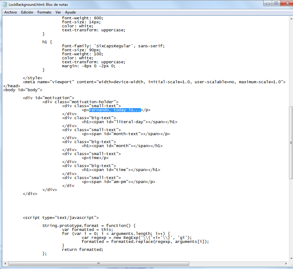

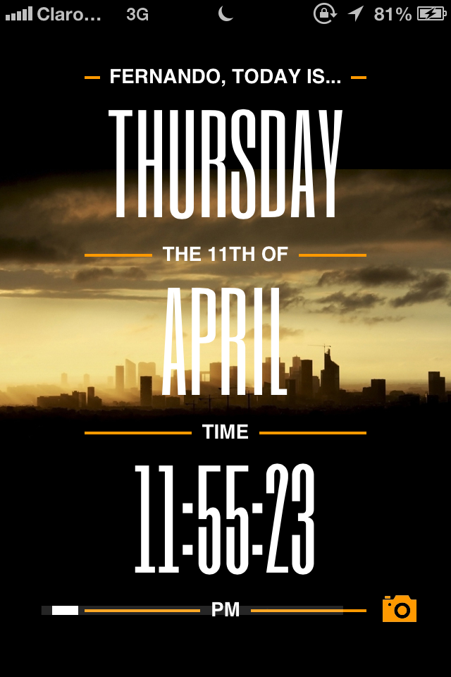

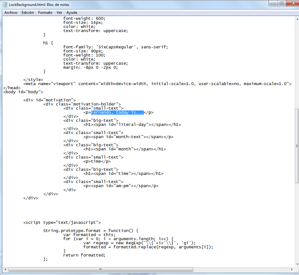

Where it said fernando/ guess what. How do i change that?
Here you go...
<div id="motivation">
<div class="motivation-holder">
<div class="small-text">
<p>Fernando, today is...</p>
</div>
<div class="big-text">
<h1><span id="literal-day"></span></h1>
</div>
<p><span id="month-text"></span></p>
</div>
<h1><span id="month"></span></h1>
</div>
<p>time</p>
</div>
<h1><span id="time"></span></h1>
</div>
<p><span id="am-pm"></span</p>
</div
</div>
</div>

One more thing,
Can i make the text more wider? It annoying to read it when the time text is so tall and skinny.

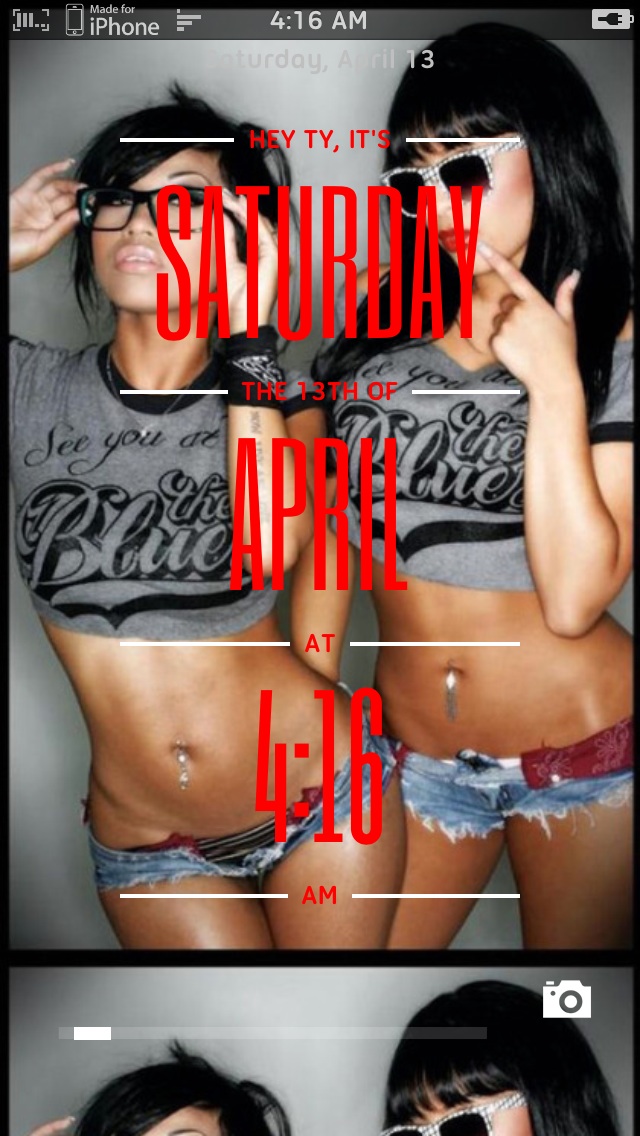

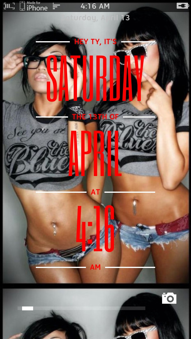

I changed the color to red so it's easier to see on my white bg lol
Please post some screen captures of your lock screen

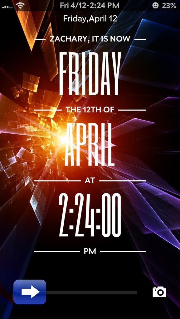

Here
