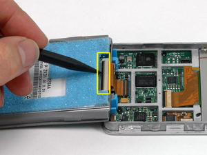

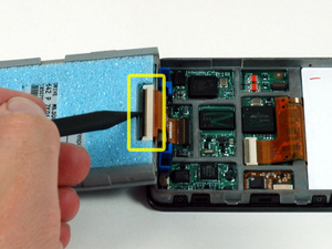

Ok so i have been analyzing the pictures on iFixit of the iPod HDD attachment point and it appears to be the same so I think i am going to move on with this project. I will be replacing the 5G screen with a 5.5G screen wile i have it open as well. My one question; Will the firmware on my iPod run the 120GB iPod Classic HDD?
I have attached photos of the attachment below, first one is the Classic the second one is the 5G video
