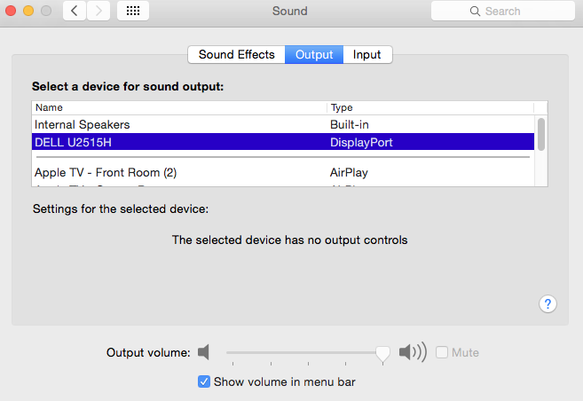

Appreciate if anyone can help regarding my U2515H not being able to play sound from attached AC511 Soundbar.
U2515H attached to a Macbook Air via display port cable. AC511 has power to it (attached to power USB on U2515H) so that isn't the problem, but when changing sound on Macbook from internal speaker to U2515H it says 'The selected device has no output control', and the output volume control is greyed out.

This is "normal" : the DisplayPort audio output is a "line-in" digital audio output, and OS X send the sound "as is" to the display, it's a bitstream content.
There is no simple solution to change that on OS X.
With Windows, you can control the volume on digital output, but there is a degradation on the sound.

I'm trying to hook the AC511 up to a U2415 monitor. I'm assuming that should work the same as the U2515. Also to my MBP. I can not get any sound out of the soundbar. I'm using your 3.5mm minijack method. The little light is lit in front of the volume knob, but no sound. I was running an old set of Harman Kardon Soundsticks II off of this monitor, so I was getting sound from the monitor's 3.5mm minijack earlier. I have Preferences set to Dell U2415 and it is continuing to show "The salected device has no output controls" Any suggestions?
Edit— Also, I did try restarting. Didn't help. When I toggle the volume with the keyboard keys it only shows on the monitor the speaker icon with the circle with diagonal bar through it.
Another edit-- finally working according to JTToft's instructions. Glad to not need all the cables connected to my MBP, but a bit annoying not to have the volume control from the keyboard or rotary on the soundbar. Fyi, cables connected to MBP are 1) power cord, 2) mini DP to monitor and 3) USB to monitor. I then have my usb keyboard and usb mouse coming off the monitor.
