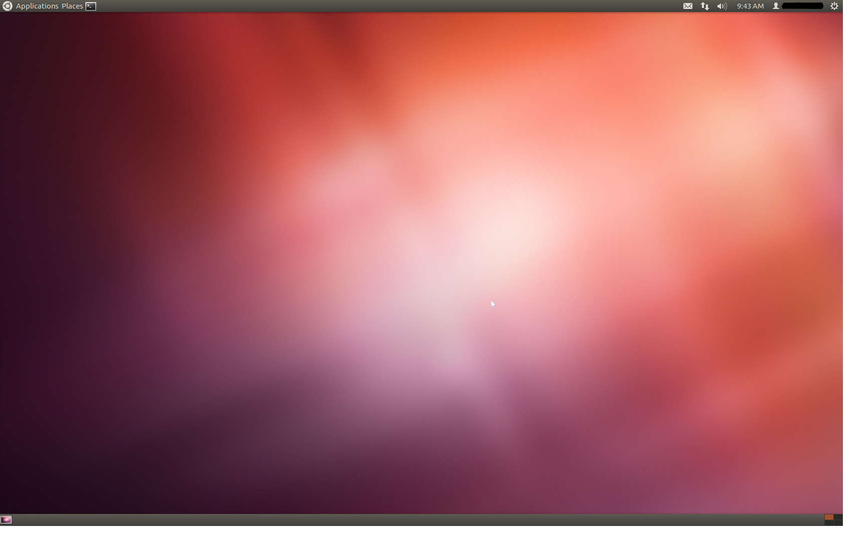

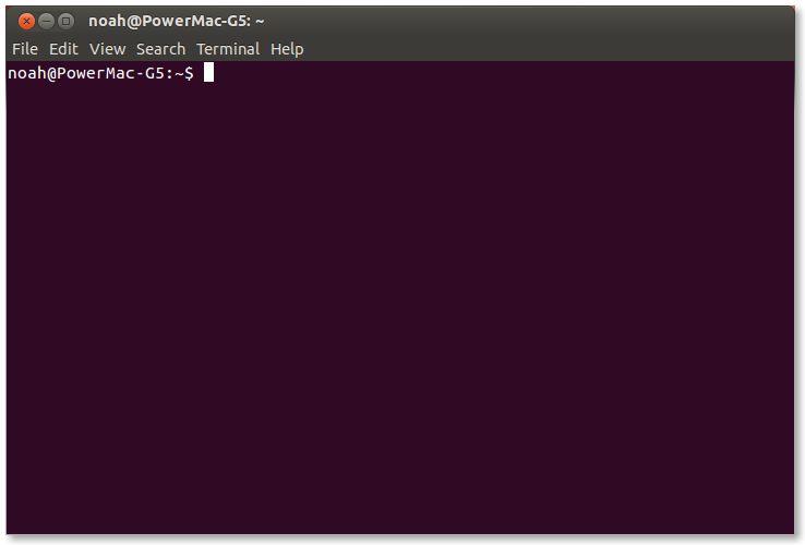

Quick post. I finally got Ubuntu working after a full year of active pursuit, and I couldn't be happier. From what I've so far seen, Ubuntu 12.04 blows OS X away in terms of capability. Browsing the web feels like you're on a much newer computer, 720p fullscreen YouTube is not an unbearable slideshow, you've got a far larger selection of applications at your fingertips, and being Linux, you command the power of gods.
Screenshot from 2018-05-29 10:00:35.png
I could really go on. And I daresay I think it's even more optimized for the PowerPC than Leopard is. It certainly appears to take greater advantage of the hardware. But that's just my freshly printed perspective.

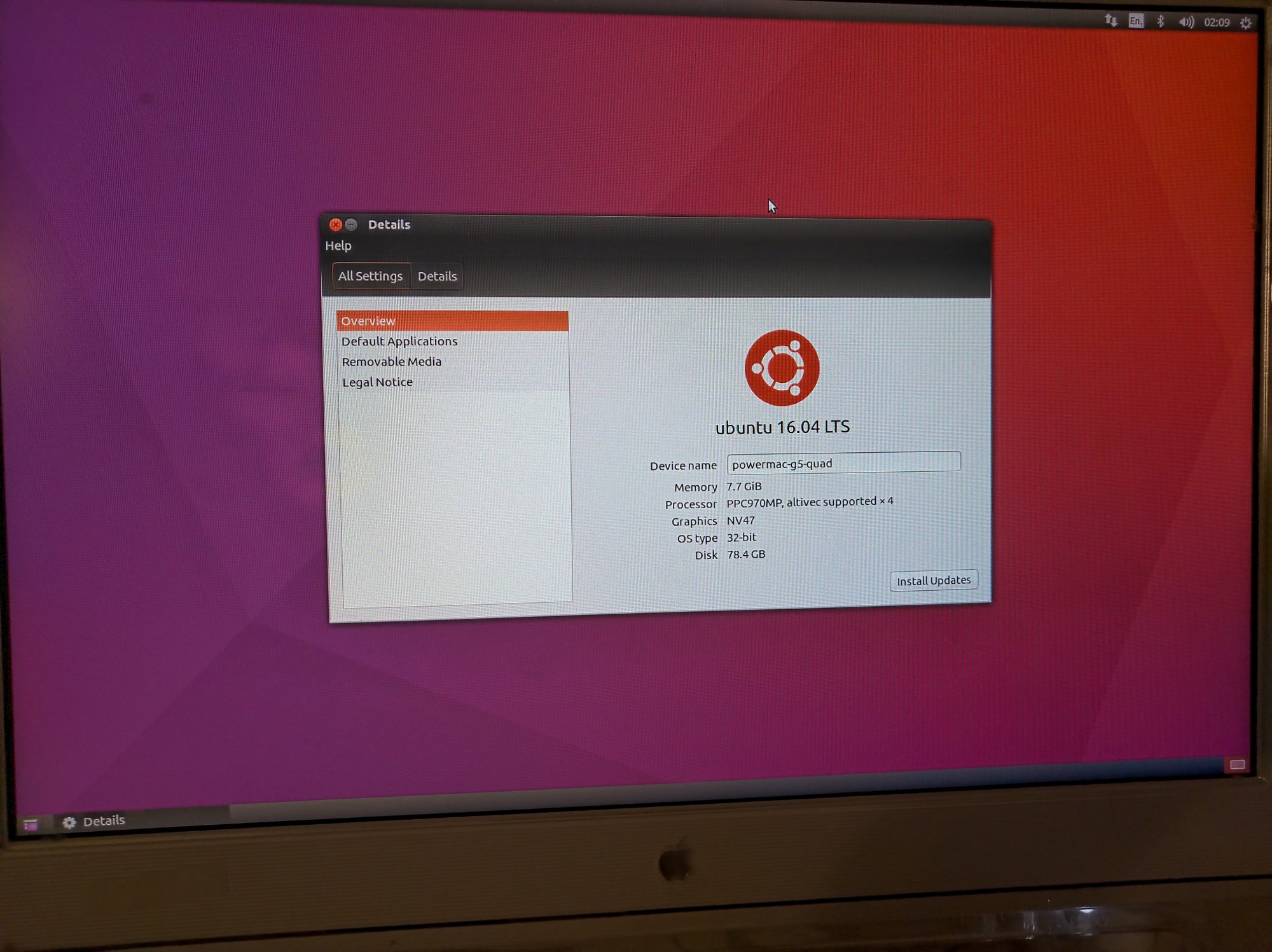

I've had luck getting full GPU acceleration on my PCIe G5 with a Quadro FX 4500 card by just disabling MSI;
Code:
nouveau.config=NvMSI=0
Otherwise, you can disable GPU acceleration altogether with;
Code:
nouveau.noaccel=1

No sleep unfortunately. But that's not a deal breaker for me. I have the G5 setup to triple boot (Leopard, Tiger and Ubuntu Mate 16.04), with OS X as the primary system.

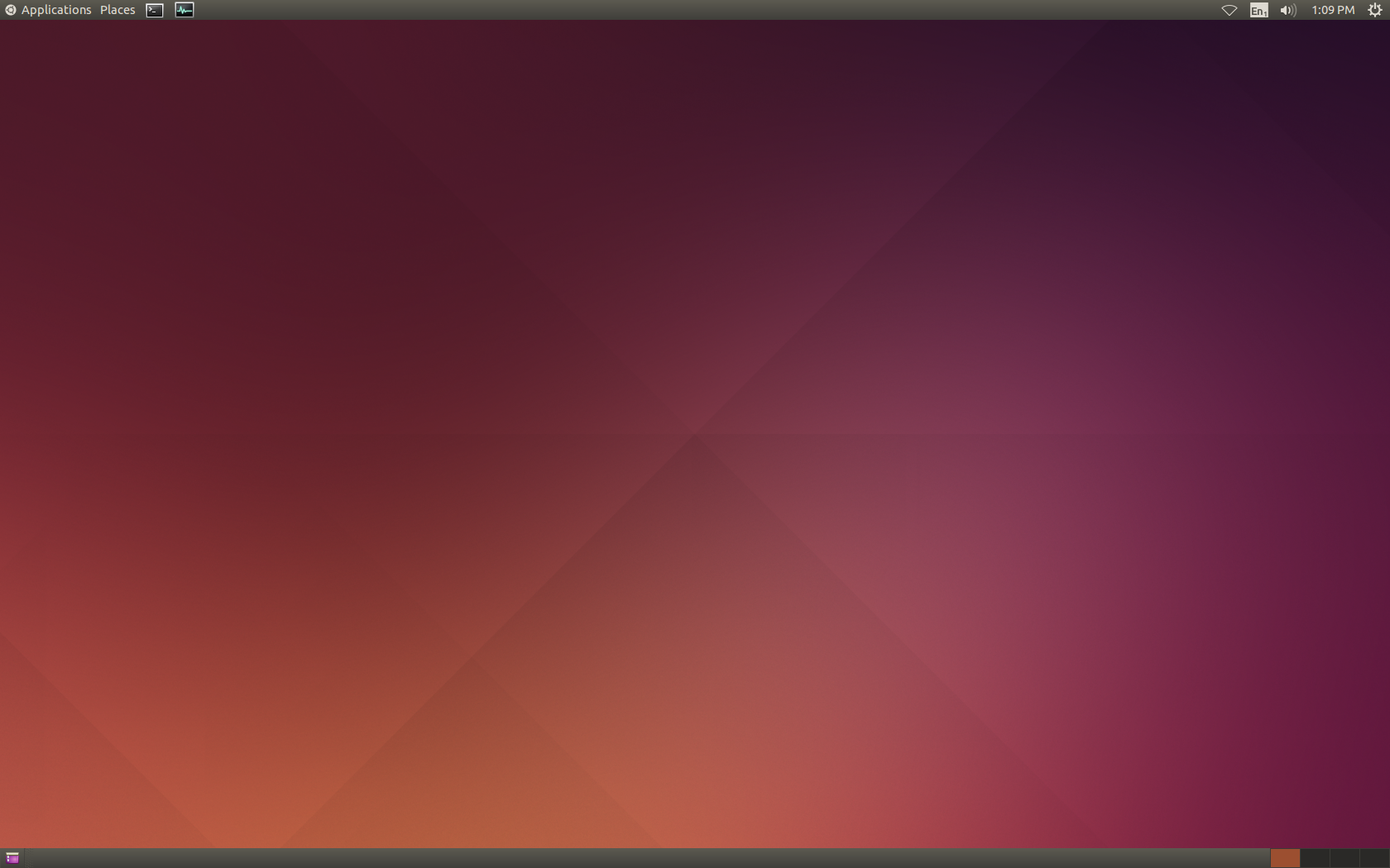

Update. Got Ubuntu Server 14.04 working under GNOME Flashback + Metacity using gnome-session-fallback, and unless there's some kind of breakthrough with 16.04 that allows people to get past the VFS error, I foresee this as final for my machine. Nothing worked under Compiz, but GNOME Flashback worked under Metacity, so I'm going to see if I can get Unity humming with Metacity. More to come.
