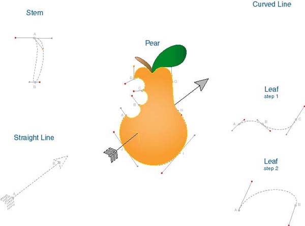

The classic Adobe-supplied shape to practice on is the half-eaten pear (see below). It's in the Adobe Illustrator Classroom In A Book. I can also recommend the Illustrator Wow! book as well.
