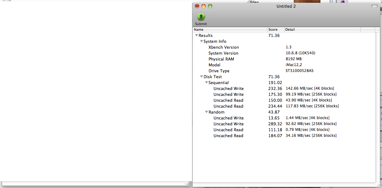

That looks OK to me. Try Crystal Disk Mark in Windows, or xbench in OSX and report back as these programs test both read and write speed at the same time.
EDIT: Here is my xbench scores of the same hard drive I did a week ago.

with "turn off Windows write-cache buffer flushing" enabled i got
a nice evened out result bar any drops. that previous graph just doesn't look right. i made a few hd tests in the past and they were never that extreme.
plus with bootcamp while copying files the machine is barely usable.
seems to be a problem with win7. got about the same results with xbench.
