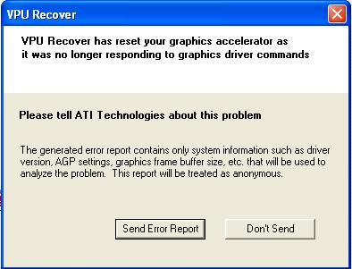

Just be careful how far you go. I just got this after it froze for about 15 seconds.
Yeah, that kind of error is normal after you hit the ceiling. Clearly you'll want to run it a little slower than the speed that caused that. 😉
