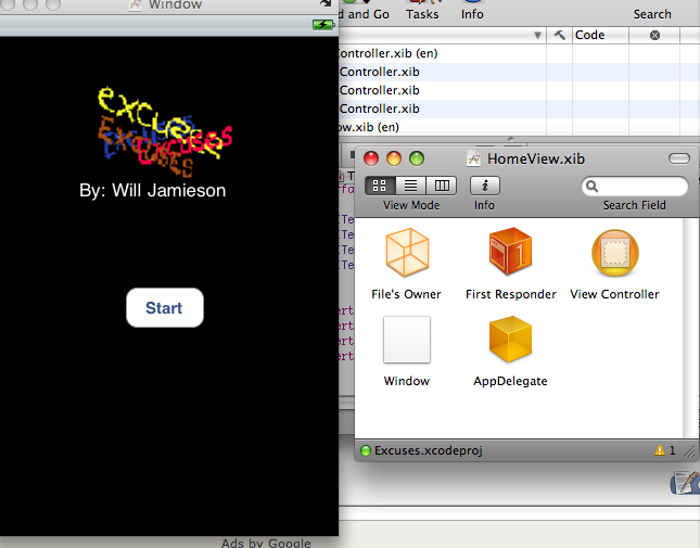

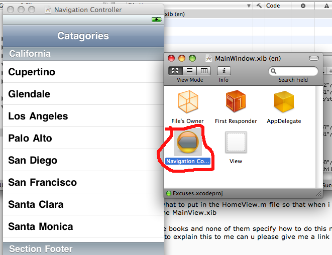

sorry about making things unclear here are some screen shots
the one picture with just the button and the window circled is going to be my home page and i am trying to link that to the 2nd picture with the navigation menu
i hope this clears it up a little

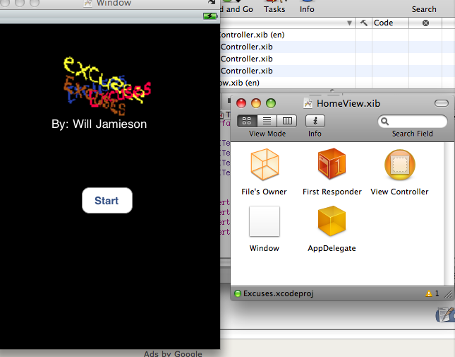

and I want to go from the HomeView.xib to the MainWindow.xib and the HomeView is being viewed in the Window option. Would it make more sense if ti was being displayed in the View Controller option?

Alright, starting to become clearer. Now, what do you have in terms of viewControllers? Do you have a HomeViewController class? And do you have a class for your navigationController that is a subclass of UINavigationController?
I think you may be able to accomplish the transition to the Categories view using UIViewController's presentModalViewController:animated: but I think I need to understand your setup better.
Yes i Have a HomeViewController class and I think i have the class for the navigation controllers but i am not sure the class just makes it so that when you touch one of the catagories then it brings you to that screen but i dont mention a UINavigation controller any where in the Catagories supporting class.

I think that you have added your start view as a subview to the Window. That's not a good idea.
Do you have an idea of how you want the Start view to go away or are you flexible about that?
Here's one way to do this.
Add the navbar view and rootview, Categories view, to the window in your app delegate.
Also push the Start view as a modal view using presentModalViewController.
When the app first appears you'll see the Start view.
When the start button is pressed the modal view is dismissed with dismissModalViewControllerAnimated and the Start view will slide off the screen revealing the Navbar and Category view.
You need a view controller for the Start view, but it will do very little except respond to the button tap.

I recommend that you build a navbar app from template. It creates a framework of an app that shows a navbar and a table as the rootview controller that goes below the navbar. Your app will be very similar.
You'll see code like this:
Code:
- (void)applicationDidFinishLaunching:(UIApplication *)application
	// Configure and show the window
	[window addSubview:[navigationController view]];
	[navigationController pushViewController:rootviewController animated:NO];
	[window makeKeyAndVisible];
You want to add this:
Code:
	[rootviewController presentModalViewController:startViewController animated:NO];
Caveat, I haven't tried this.
You need to create a startViewController that has as its view the Start view. The start view goes in its own xib and its file's owner is StartViewController, or whatever you want to name it. You add an IBOutlet to the app delegate called startViewController. You need to connect that in IB like the rootViewController is connected to the app delegate in the navbar app you built from the template. The startViewController will be created when the app launches and loads the MainWindow.xib file.
Add your IBAction to the startViewController and have the action method dismissModalViewControllerAnimated.
