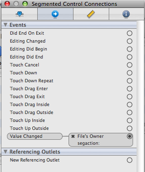

No, by Value Changed event, I mean that very event in the Connections Inspector in Interface Builder. Should look something like this:
Thanks for taking the time to get the screenshot, and I did make the change (from Touch Up Inside, I still am seeing this as more of a button then not, I guess). Even now though, I am still not having success: The segmentcontroller now does not appear, and it appears SubclassC is loaded as the application launches instead of View.

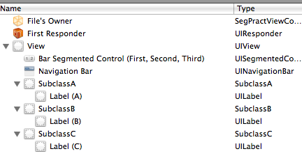

Heres a picture of my IB Document also, if that may explain something:

do you have your segmented control connected to your controller via IB ? It looks like your segmented control might not be calling your IBAction method. And the events for segmented control should be "Value Changed"
i think you mean "do i have my segmented control connected to my action via IB? The answer to that is yes. The segmentedcontrol is now calling the IBAction, and the events are now "Value Changed". 🙁Luckily, a few more problems have arisen so I can continue battling something that seems so simple. My problem now is that all 3 subviews cannot be located correctly without becoming subviews of eachother. Secondly, the application opens to Subclass C instead of Subclass A. I don't know why that is (and yes, the Subclass A segment is highlighted when the app opens). When I navigate to some other views, I can choose the segment it started on (that opens to Subclass C), and it calls the correct Subclass A. There should be simple solutions to both of these, I predict. Anybody want to inform me what they are? 😀 Thanks for helping me with the little kinks I had before - For some reason there aren't any decent code examples/tutorials on UISegmentedControls to switch views.
