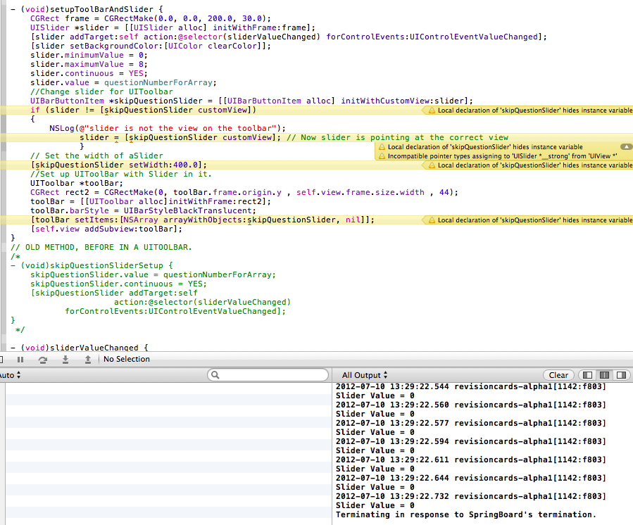

So, I made that change and ran it again and moved the UISlider - I still get only 0's in my log.

Read the warnings. They are telling you exactly what I told you above: you have local variables in that method. They are in scope for that one method only. If you don't understand variable scope stop typing and go and learn the basics of C and then Objective-C as this is core, basic stuff.
I do understand the basics of this, it's just that we are declaring UIBarButtonItem as the slider, and I am confused as to how this works when the slider is actually a UISlider. And I haven't declared skipQuestionSlider other than in this method, because I wasn't sure what to declare it as (UIBarButtonItem or UISlider).
The compiler warnings say otherwise. They are telling you that you have a local variable hiding an instance variable.
This is a similar issue to the one you encountered in another thread of yours. I suggest you step back from the real coding and learn about 'variable scope'. It's a very important concept to understand.
