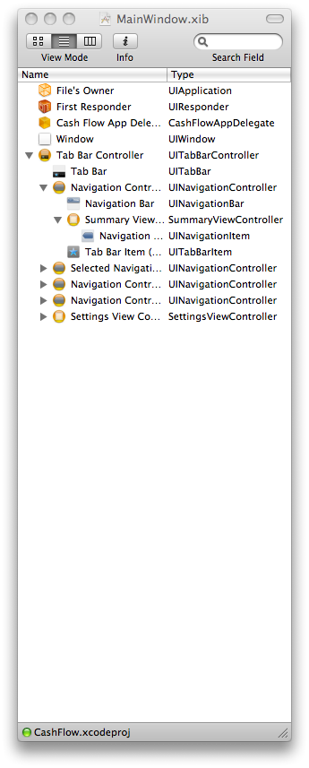

I have a similar concept to you in one of my projects. My MainWindow.xib contains a TabBarController. Most of the tabs then contain a navigation controller, and the default view of the navigation controllers is a view that contains a table view. Look at the attached image - in my case SummaryViewController is the controller of the SummaryView.xib containing the table view. In your case, substitute SummaryViewController for navFooCtrlr.
