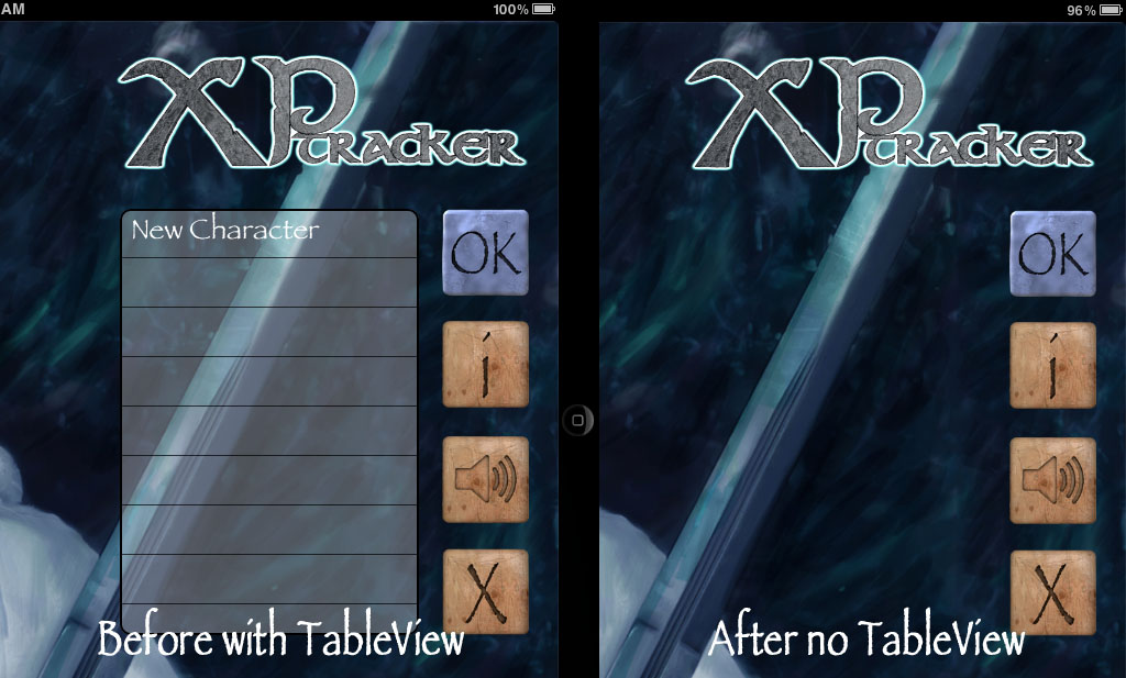

Here is an image to help show my problem. It happened again this morning so I took a screen shot on my iPad.
The tableView is allocated memory and initiated. Could it be something with ARC that is managing the removal of objects?
My 'if' statement should catch if the object exists or not, if it is removed it will create a new one. I'm assuming the if statemented is returning a false so it sees the object in memory and won't create a new one. But then it is not being drawn to the screen.
So odd.
In your if statement, you are checking if the table view exists, not if it has been added as a subview. If you are using ARC, then you should declare the table view as a weak property instead of an ivar. So if your view along with your table disappears, your weak reference to it will be nil. And your if condition will work.

You are correct. It is ios 5. I didn't even think of the low memory issue and how that could unload. There is a lot that is happening in my app so that might be the problem then. Correct again the buttons are nibs. Only the tableView is created programaticlly.
