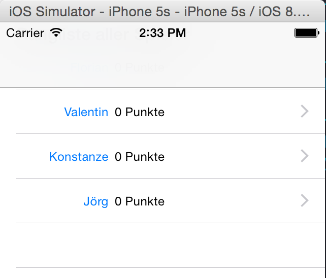

I'm working at an App in which I use a UITableViewController.
Its UITableView is scrolled to low automatically (when starting the App). I already tried to take a whole new UITV, but the mistake was still there.
Can anyone help me ? How can I fix this ?
I'm also using other UITVCs in my App which work, so I wondered if this was a bug in the new Xcode version ?
Here are 2 screenshots of this issue:

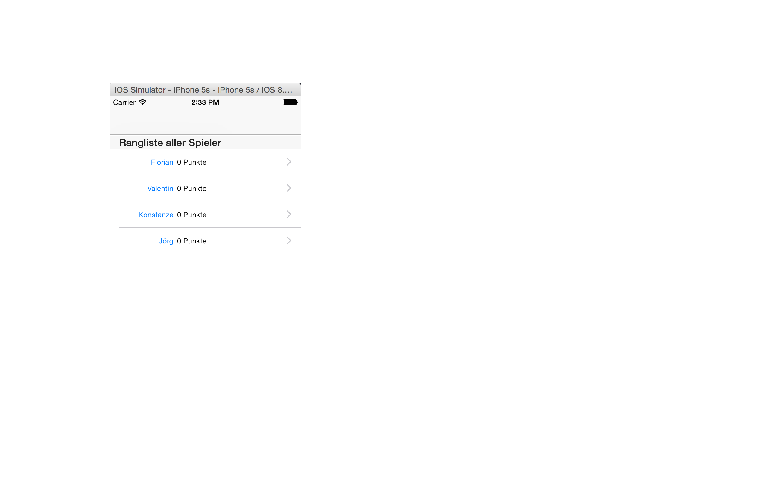

(In the first image its the normal state: I didn't do anything.)
(In the second image I scrolled up and then did the screenshot to see how it should look.)
Thank you for your help !
(sorry for the format of the second screenshot)

As I said, it has nothing to do with my code. I think it's just a bug of Xcode, but the question is how to fix it (maybe by scrolling to the beginning in code, but I don't know how to do this).

I think the problem being described is that when the app starts the table view shows as in image 1. After scrolling the tableview it looks like in image 2. The first row, with text 'florian' and the group header, with text 'Rangliste...' aren't visible until the table is manually scrolled. The first row and header are under the navigation controller until being manually scrolled.
Is this correct OP? I would call that scrolls too high but that's not important.

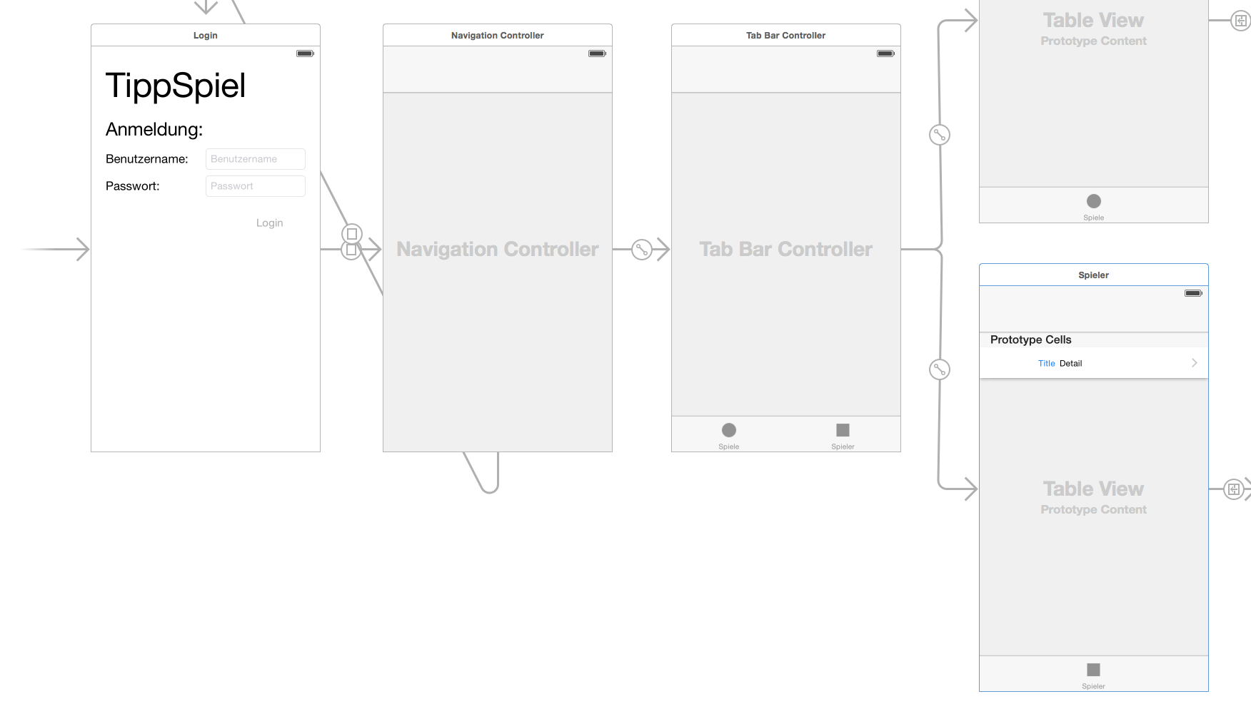

How is the UI created? nib, storyboard, code?
What is the UI hierarchy for this screen? Nav controller? Root UIView? Root UITableViewController? Can you show a screenshot from IB?

Its one tab of a TabBarController, which is additionally managed by a NavigationController (before the TabBarController):
UIVC -> UINavigationController -> TabBarController ->UITVC:
The problem is just like it is described by PhoneyDeveloper.
The hierarchy is created just in the storyboard (see picture).

The TableViewController in the bottom right-corner is the one where the problem occurs.

There is a property on UIViewController that is automaticallyAdjustsScrollViewInsets
Do you have this set to yes or no? It can be set in Interface Builder
