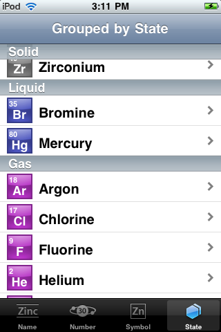

As seen in “Figure 1-4”, Apple appear to be able to do it.

Well, that screenshot is from the Elements sample. Did you check the source code?
Oh no I didn’t, good suggestion! I shall now…
Edit: Well, as far as I can see, it appears to be using a completely custom table view cell to render the data, including the label, mainly I guess because it’s not actually an image but a custom view that’s being rendered. Oh well, I guess unless someone says differently, I’ll just shrink the icons for now. Thanks anyway!
Actually that screenshot must be from a modified version of The Elements. The sample app uses a plain and not grouped table style:

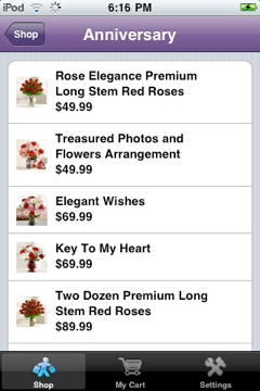

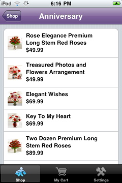

I think u can try increasing the height of cell ,that might help u.As u can see in the screen shot below

Thanks for all your input. As this part of the app is a “major” part with few items, I eventually settled on increasing the height of the cell to 60px, which makes it overall look better and coincidentally fixes the problem with the images by shifting them to the correct position. It seems that the table view expects images to be of a certain size, but if they’re larger, it appears to lock their “right” positions, making them appear off-centre.
Anyway, all fixed now, thanks!
