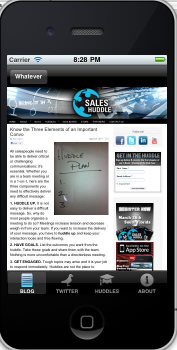

It'll take longer to explain than it did to do it.
I downloaded the source.
For some strange reason there was no WebViewController.xib file in there even though all the code was in that view controller.
I copied one of the other copies that looked like it was supposed to be the WebViewController.xib file and added in the toolbar in IB.
Commented out all the code that built the toolbar.
Added a single action method "whatever" and hooked up the single toolbar button to this action method.
Adjusted the struts for the toolbar and the webview so they don't cover each other.
Build and Run.
Is that the goal of this exercise?
Yes, this UI is different than the usual one. You don't usually have a toolbar on the top like this on iPhone so I guess there might not be any examples exactly like this.
So does the uploaded project do what you want?
yeah, the BlogViewController.xib is the IB file for WebViewController.h/.m
is that where I messed up? do I need to rename that .xib or what?
The way your code is set up you call alloc/init for your view controllers but you don't ever specify the name of the nib file. That works if the nib file is the same name as the view controller. Otherwise there's no way for the base class to know which nib to load.

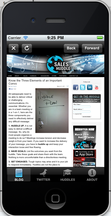

OMG, I got it!!!! Thank YOU Thank YOU phoney developer and Dejo you guys have been wonderful! I see exactly what I did wrong!!!!!
I don't usually depend on the behavior of the base class to load a nib that has the same name as the class, like you're doing in this code. Since you already have an override of initWithNibName you can just add the correct nib name on the line that calls super initWithNibName. Then your nib can have whatever name you like.
Here is the final code used.... thanks again guys, i cant say it enough!

Final Image:
