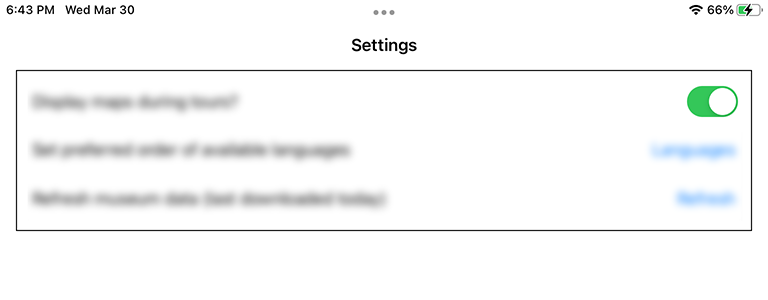

Here's how the top of the iPad screen looks in the simulator:
Here's how it looks on a real iPad when connected to my Mac and run via the simulator:

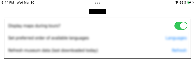

And here's how it looks if I stop running the simulator and launch it independently on the iPad. As you can see, the black text gets a black background, making it unreadable.

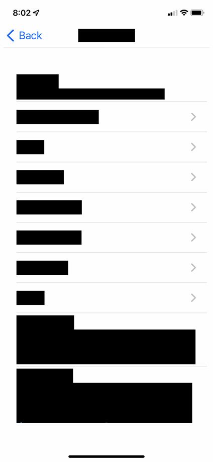

Black text in a UITableView (on a white background) also turns to black-on-black and becomes unreadable. Example:

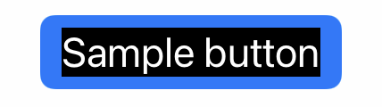

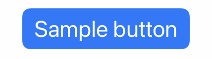

UIButtons with the "Filled" style have white text on a blue background in the simulator, but running directly on the iPad they have white text with a black background, inside a frame of blue. Example in the simulator:
On a real device:

I used all of the suggestions above, which proved that the problem is unique to this project, affecting all buttons and certain other views. The project has some imported third-party code, so I disabled one component at a time to see if one of them might be the guilty party. Sure enough, one of them included a backgroundColor extension to UIView with a getter and a setter that looked harmless, but weren't in fact harmless. That extension is not needed, is now disabled, and the black backgrounds are gone at last! Thanks for the help.
